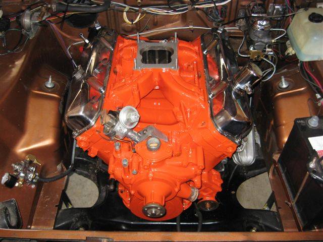

Found this, pretty good example:
when i modified my crossram max wedge intake i bolted it to the milling machine fixture so as much less chance of heat distortion that the TIG welder would generate. and it got Darned hot...
