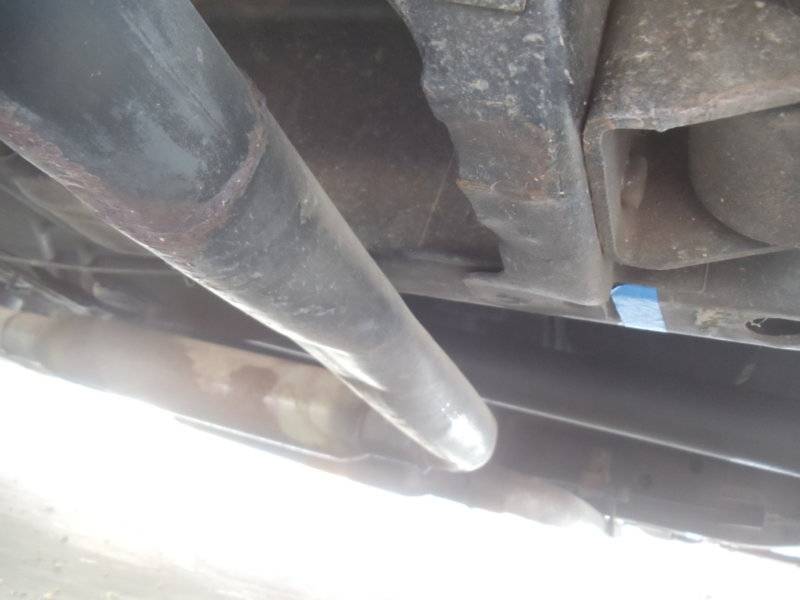

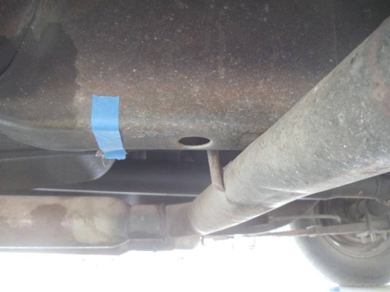

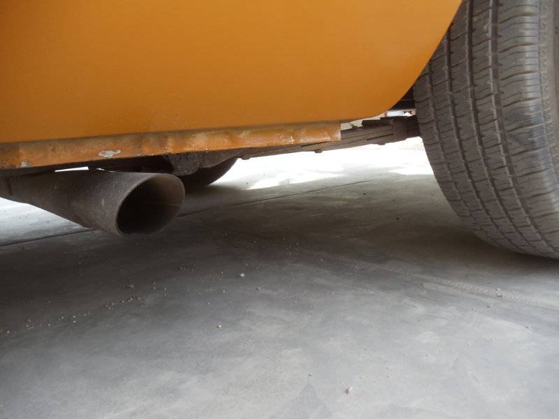

Browsing through my '72 Factory Service Manual I stopped on page 0-6 to find the specified frame lift points, the rear point recommended as being b/t 23" and 33" ahead of the rear axle centerline. I measure and place blue masking tape at those specified points and what do I find? The muffler shop located my side exhaust outlets smack dab in the middle!
The good news is that I have been seriously considering the addition of a pair of resonators to shush up the "Purple Hornies" we installed with the side exhaust. We'll take on the mods later this year.

This is for future shops and owners/relatives when the car is on a lift and I am not around to supervise the numbskulls. I can jack-up by way of differential for now.
Place jack right behind the pipe. That is where I always lift.......I've never looked at the manual for that though. Certainly not worth moving the pipe for though in my opinion.
