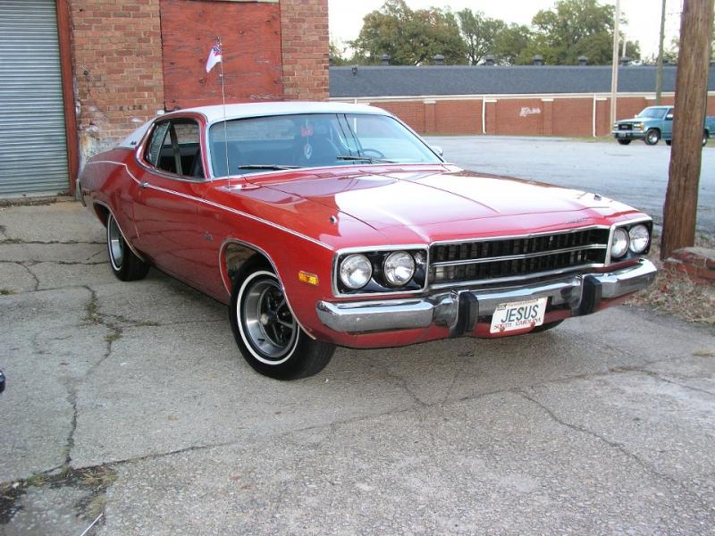

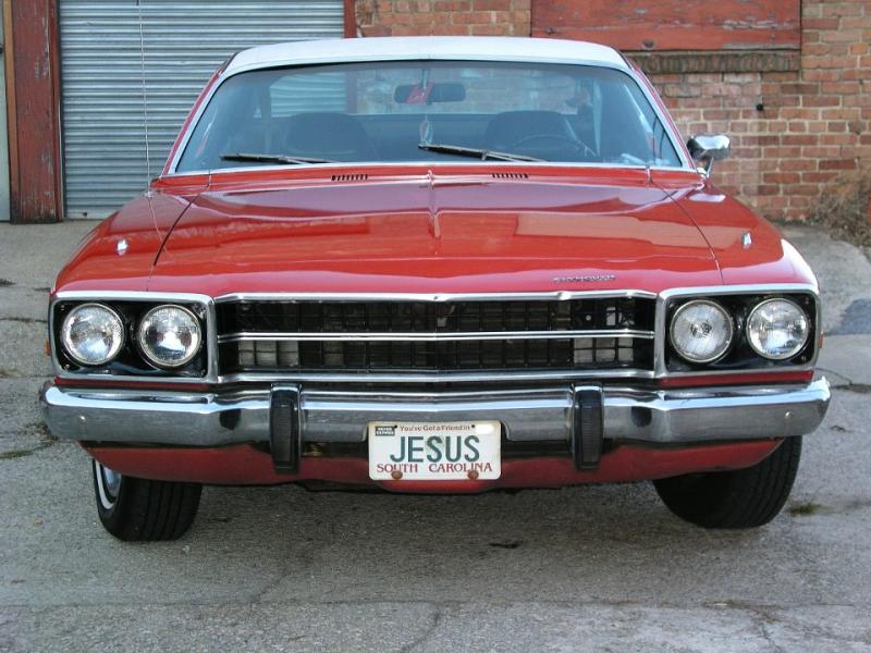

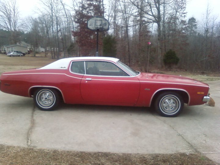

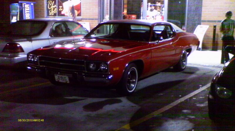

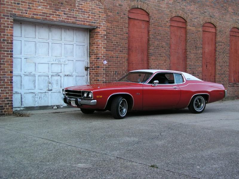

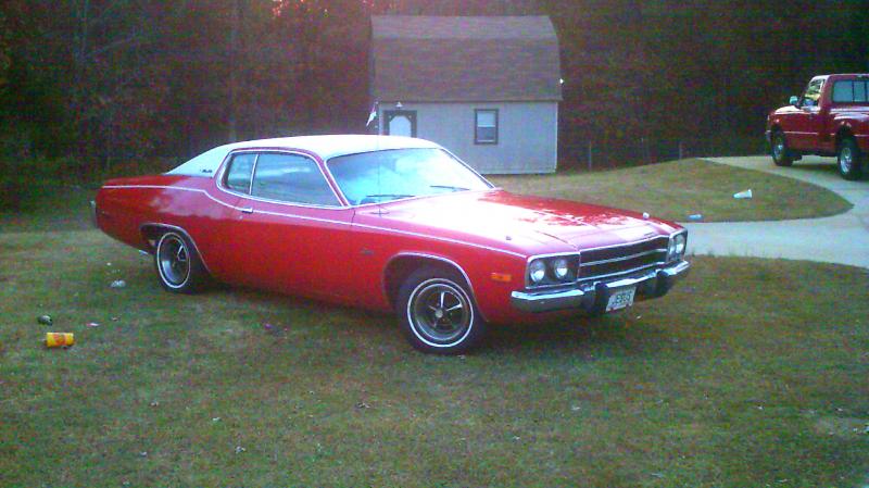

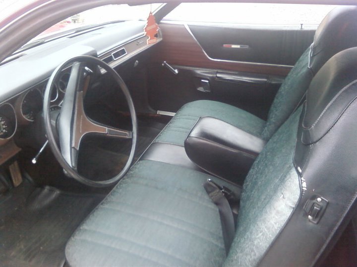

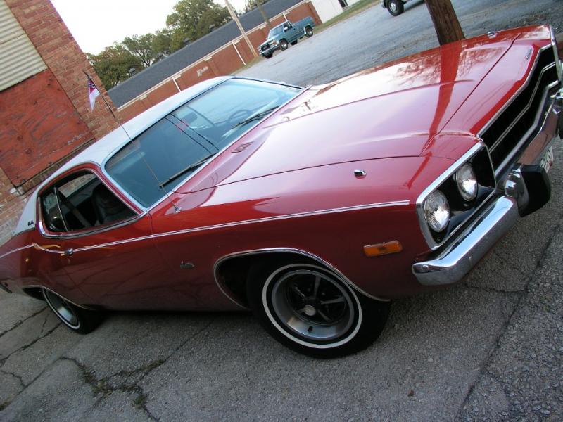

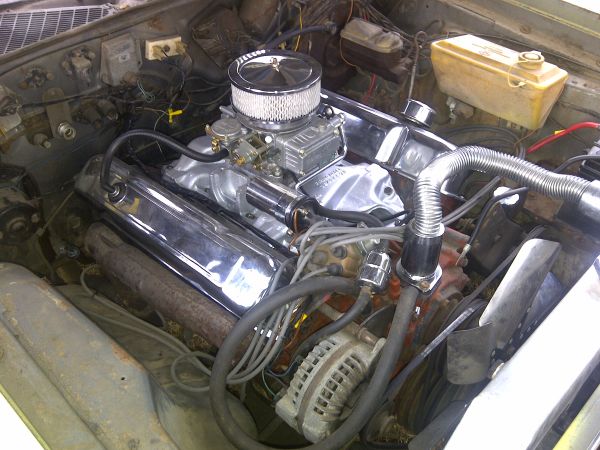

So I havent been on here in awhile because of school and work and being a 17 year old kid with an old car is a challenge but I am back and to show some pictures of my finished Satellite sebring plus. Its is still a 2 barrel but I am wondering what I could do to upgrade power? Any ideas? Thanks for looking and have a blessed day :headbang:

its a bit tough to really get a big jump in power with a 2 bbl. but you can do some small tuning things to get the most out of it. if you have a well curved distributer you can bump up the timming a bit. try about 12-15 degrees initial you want about 34 to 35 total mechanical advance, it will make it a bit sharper but you wont be able to do that with a stock distributer. and make sure it has a good tune up plugs cap rotor. the new parts store cap and rotors are junk you need to get a cap with the brass terminals if you can find one they run and last longer. if you want more you will want dual exhaust a bit of cam and for sure a 4 barrell also some more gear and a converter would be nice to, but all that stuff costs some money. hope you get it sorted and have fun!

If people are wondering the paint on the car is all original and the top is to, the interior is mint for a 39 year old car and the engine bay is still nasty looking but it runs fine. All I have really done was pull the motor and replace all the gaskets on it and before I got the car 2 years ago it had sat for 25 years. But I shall take a few of the engine and inside to show you guys later. Ohhhh and I painted the headlight covers and grill after seeing a blue roadrunner on here with that painted, I liked it xD

I didn't notice the grill and lights all where painted and its a change that looks good on it makes you wonder why it wasnt offered. Great looking Sat I would keep it stock if its that original.

p.s. I think raised white letter tires would make it look tough instead of the white walls. JMO..

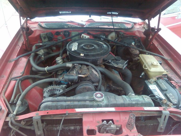

I am also in the upstate, and I have seen 2 a brown 73 and a yellow 71 rr clone. But I have an older pictures of the car when I first got it, and some of the engine and inside.165581_122186771182439_100001733514878_117330_5948461_n.jpg167277_130819826985800_100001733514878_164724_1561527_n.jpg167717_129279107139872_100001733514878_157308_5075185_n.jpg

For an easy upgrade of the small block 318 put headers on. Not cheap but you'll easily add 20 to 25 hp to the engine plus get the benefit of a nice sound. For a little more work. Upgrade the top side of the engine. Switch out the 318 heads with 360 heads, have someone do a little grinding to them to help with the flow, switch out the stock intake with a performer intake maniford and add a 4 barrell to it. You'll feel the difference but you'll looking at 600 to 700 dollars.

Awesome engine bay pic. Its nice to see what mine used to look like. Im trying to decide if I should keep the a/c parts in there or take them out.my RR1.jpg
