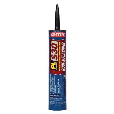

But if you use polyurethane it will never come out.
I've used this on windshield gaskets.
And Duster rear side windows when the rubber had shrunk up and made a gap..
I stretched and clamped the rubber back in the frame till it set.
Still good after 15 years of everyday use.
