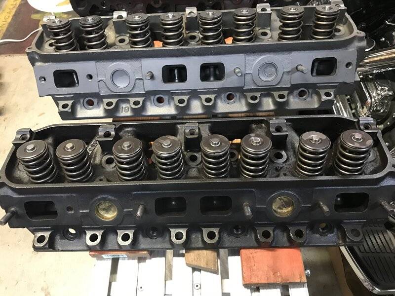

I have a set of 516's and 915's and the ports on the 915's are a lot bigger
Compare the port size on the 516's in the back vs. the 915's in front. Also look at valve spring size between both.

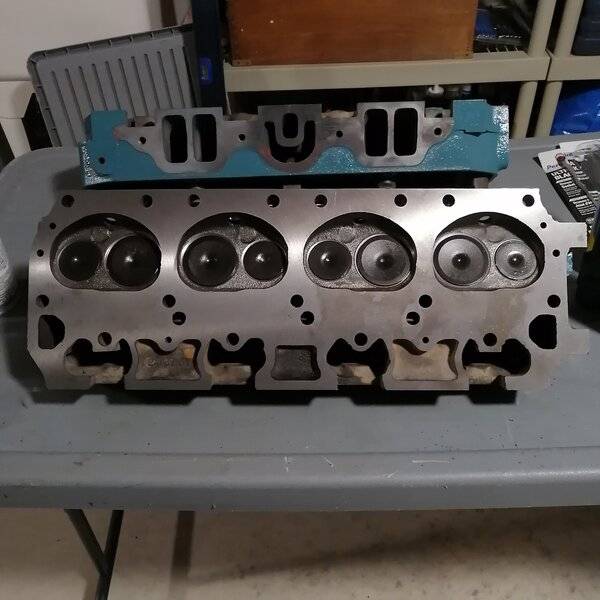

I just had my 516's done. Much smaller and flatter ports with almost no short turn. They did come in at 75 cc's with a .020 clean up cut. They will work fine for my mild build with a torque/RV cam.
