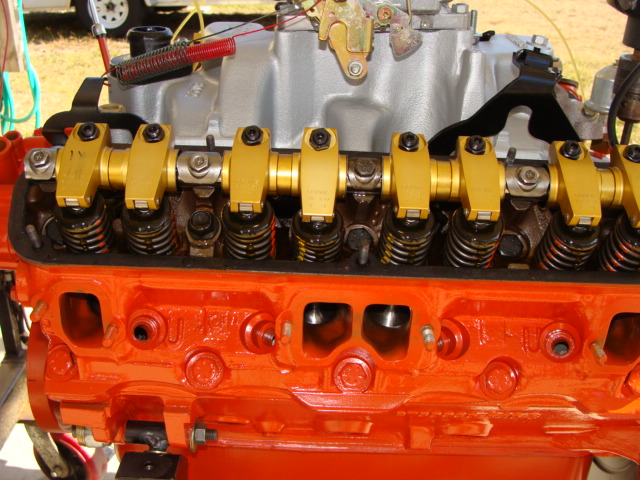

Here is a picture of where to look for the letter. Sometimes "U" heads can be mistaken for "J" heads.
Look close at the first and last spark plug hole. This is a set of "U" heads. As the spark plug hole was machined from the blank casting, it removed a portion of the letter.
And yes Mark, this is a set of 1970 915 heads.
But they are not the "special" T/A heads that use the offset rockers.
