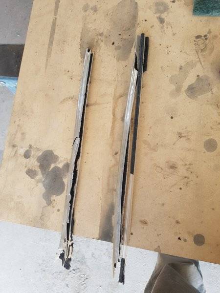

So these came off the windows of my 1970 Plymouth Satellite where they sit into the guides. They were held in by little plastic pieces top and bottom and act as the rail that runs in the guide. I need new clips and the new liners but aren't exactly sure what the proper name is. The liners I will call them have felt inside and seem like a thin plastic outer. A link to what they are and where I can order them would be much appreciated. Thanks.
Can't remember what they were called but found them at Year One in their weatherstripping section. Maybe door glass seals?
Those are the mylar glass channel runs. NOS runs are very limited and do fit much better than the reproductions. If you should purchase the reproductions, you may want to consider using the original "H" pins or slightly sand the reproductions down slightly. Either style will need to be trimmed to fit as they have numerous applications and year model coverage.
There has been a shortage of the reproductions as well in the past couple of months, so you may have to check with a couple of vendors that may actually have them in stock.

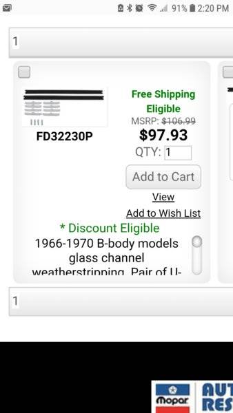

As usual, thank you guys. I found them at both Year One and at Dante's. I've ordered stuff from both, and had good luck. I finally heard my car run on Friday. Its been 3 years. I'm trying to get my car safety certified by September. That will allow me to register and finally get some insurance on it. I should be able to enjoy 1 or 2 short drives before it gets out away for the long, cold winter we have here. Thanks again.
These are called 'expensive'. I just installed Mopar ones I recently purchased. I used the clips and pins that came with the new ones. No issues at all, windows roll up/down with ease.
