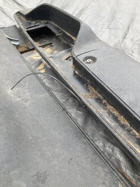

The center console has these two plastic tie wrap type of straps on both sides. These straps have the seat belt go through to prevent it from dropping down. Mine broke and not sure what they are called to find replacements. This came off a 73 Charger. Thanks.

Not available. Most of consoles got the provision holes for the seatbelt straps, but some other didn’t. You can see on them a slight mark or dimple on those without the hole already opened.

Thank you for the info. I’m going to have to make one then.
Not original to my car but I picked one up decades ago and of course moments after installing it I accidentally broke it while pulling out the drivers seat not realizing the strap was stuck. Been looking for a replacement as well, tried repairing mine so far no luck.
Also look at other makes and models for the strap, heard on suggestion to start with a black zip tie and try to make one.

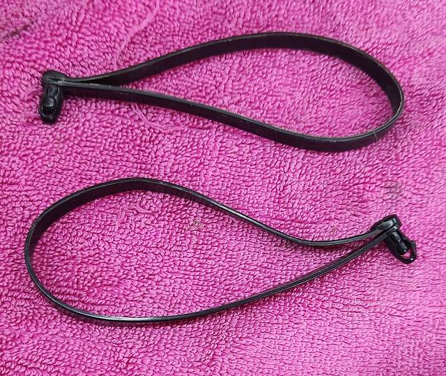

I got a 72 Charger Rallye that is kinda of a survivor car, and those are intact and in perfect shape.
Here are pictures of both the right and left side of my console with both sides intact. I can definitely see how these would very easily not survive

Years ago I got a bunch of parts from 73 or 74 RR can't remember but the 4 speed console had them. They are factory pieces for sure. I kept them cause they were so nice and not brittle..

Yep that's a factory part that both of my 72 Satellite Sebring's had, I even had NOS spares for a while but gave them to a friend in a package deal.
