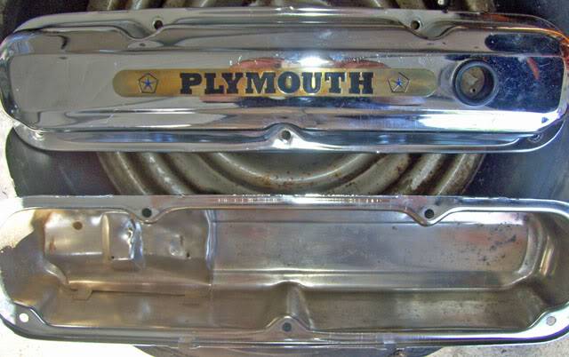

What are these Valve Covers from?
Ltlgto
10:01 AM
May 3, 2011
98
18
SW Washington
I got these valve covers from a guy that I bought my tires and wheels from on CL. The tires/wheels and valve covers were his girlfriends old boyfriends. Revenge selling !!! Gave them to me just to get rid of them. Are they for a particular car or? I dont even know if they're big or small block.
Man those are cool...Too bad they are smallblock...
Petty Blue 67 gTx
Aftermarket generic covers for a small block.Had a set on my old PW 318 for a while,they needed the same mod to the baffles to clear the rockers as those!
RT
ooops ! didnt know small block valve covers had same bolt pattern ! ....
Thanks guys. So they should fit on my 273? At least until I find a big block for it.
