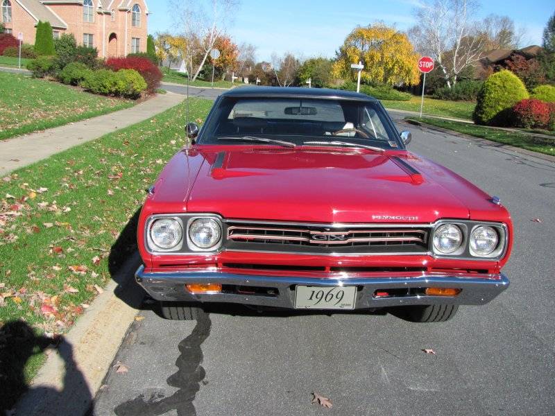

My 69 GTX has the light argent bezels. Much different from the dark argent grill if you look at Black_Sheep's pic above.

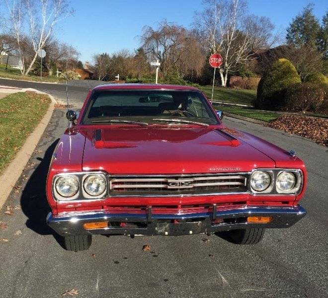

When I bought GTX number five, the originals had been re-anodized, then painted with Road Runner argent. The car had been restored by a Chevy guy, who didn't know the difference. This was just one of many detail items that almost led to me to pass on the car. That was eventually outweighed by the fact the seller was a close friend of Jeff Bobst (builder of the Hemi Cuda convertibles featured in the Nash Bridges TV show). Jeff had supplied many premium OEM parts and assisted with the restoration.
I salvaged the bezels by spraying over the darker paint with light silver from a rattle can. With the thin layer on top of the textured argent, it was hard to tell them from correct originals. My current car for comparison on right, wearing correct restored bezels done by Kruisin Moons.
