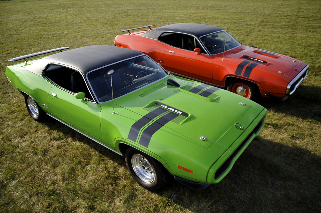

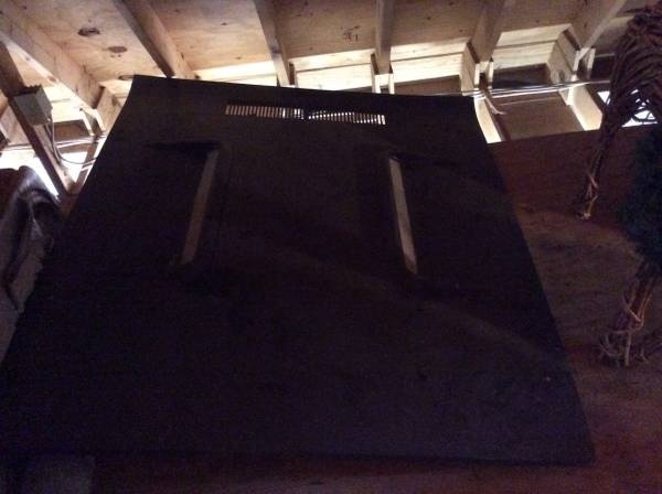

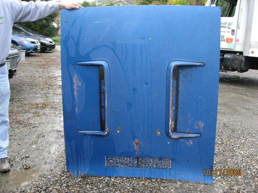

I have seen two different mounting locations on 1971 Roadrunner ,GTX, and Satellite. Turn indicators. Halfway back the fenders and center rear of the hood. We were discussing this in the shop yesterday.
I have cars here with two different locations. What determined the Mounting location on the assembly line when they were installed?
Air grabber cars could not have them in the center and mostly the cars with them in the center were the non-air grabber performance hoods. Does anyone know if they were installed on the fenders with the standard performance hood package? Thanks Steve

The RR bulge hood I put on my '72 Satellite had the turn signals in the middle of the hood, as you show in the picture. I would think it would be a difference between '71 and '72 hoods, but I never saw enough bulge hoods to substantiate that.

the answer to your question is no
air grabber and flat hood cars were on the fenders
and the standard runner hoods were only on the hoods..

That is what I have been seeing. I have never seen a bulge hood car with them on the fender . I only saw air grabber and satellite hoods with them on the fender.
I now have three bulge hoods two 71's and a 72 Roadrunner GTX. Only one of the 71's had them on the hood but the others didn't come with any except for my Satellite which I pictured. My nicest bulge hood has them on the hood and my nicest fenders have them on the fenders. I guess if I use and Air grabber hood I'll leave them on the fenders. But that $2500 repo option is a little out of my reach for now. I will splurge for the louver and elastomere bumper option
