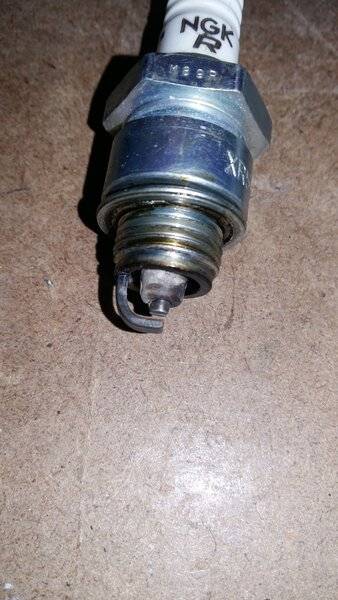

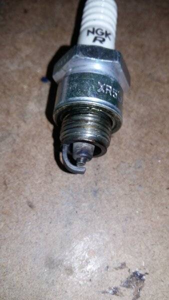

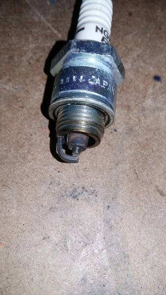

Little back ground. I did the stealth HEI module swap inside the orange ecu box, gutted the ballast and got a summit E-coil. The car started right up, I'm running a wideband O2 and saw that it leaned out my idle so I adjusted the mixture and adjusted my rpm a bit and double checked my initial timing at 18*. Took the car out for a spin. It seems to be running great . I had a set of plugs that had basically no run time on them I gapped them to .40 and threw them in. I drove the car to work today it ran great except about half way home I heard an odd misfire . It honestly sounded more like my muffler fell off for a split second . Kept driving as nothing else seemed to oUT of the norm. 2 Corners from my house it did the misfire again honestly sounded liken it was right inside the muffler . Last corner the car almost stalls but keeps going and evens out. I get home and the car idles perfectly fine sitting in park. Put it drive and is fine , could not get it to miss again.
I pulled a few plus to see what they look like . I am crusing at 14.0 on wideband and the car seems to be running great other than the weird misfire.
The car deffinently seems to be running cleaner dosent smell as rich as it used to.
Here are the plugs. Thoughts.......

Looks like it's running a little rich. Might try to get the afr's in the upper 14's to low 15's at cruise. What's your afr's at idle?
One note to keep in mind.... you can't just drive around, then pull plugs out and get an accurate reading.... You really need to kill engine immediately after a WOT run and then check them. Also, it seems to me anyway, you'll have a hard time getting a perfect burn all the way around the porcelain on any wedge.... it'll always be a little discolored from one side to the other, in my experience.
Old plugs, some idling in neutral, some idling in gear, some cruising, some accelerating, some decelerating. You cannot come to any real conclusion, although people seem to think they can.
Also, folks seem to believe that certain AF numbers are what you need to target because of stoichiometry/chemistry. What a chemistry book says and what a 1960 vintage motor/combustion chamber needs are two different things. Absolutly use the AF info as a tuning tool, just don't hang on too tight to some absolute numbers or values. Give the motor what it needs/wants. If you think it's AF related, try moving in both directions.
Very true, to some extent.....the basic cause is the dark colored side faces the intake valve, where it is "charge cooled" by the incoming fuel mix. AFR devices are a tool that takes an INSTANTANEOUS reading of the %O2 in the exhaust gas. Do you have a sensor in each exhaust stream or just one stream? Due to the the uneven mixture velocity characteristics and mixture densities, usually due to the manifold runner length differences, accounts for the uneven AFR numbers. Perhaps a better method is to use 2 probes and AVERAGE the combined readings over time. But unless one can make in process adjustments, at each desired operating point, the whole process seems futile. Carbs cannot be electronically conttolled (with the exception of GM's M4MEA Quadrajets) like a pulse width modulated EFI, to obtain best AFR. Just my opinion of course.....
