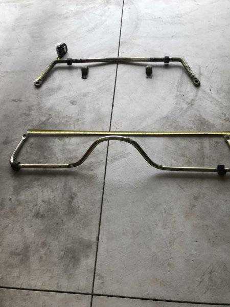

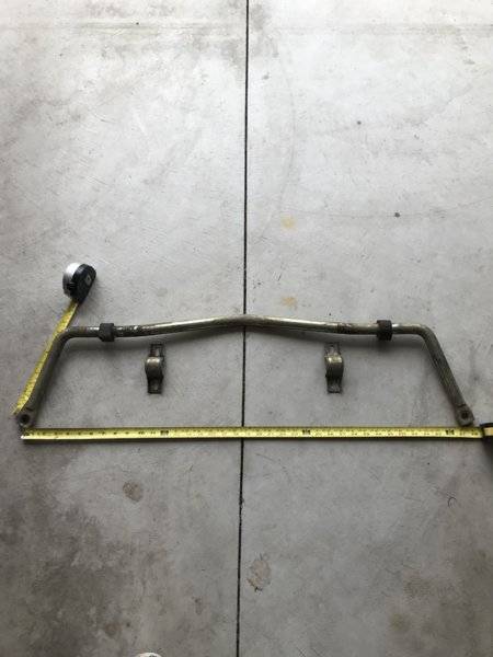

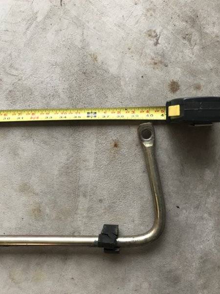

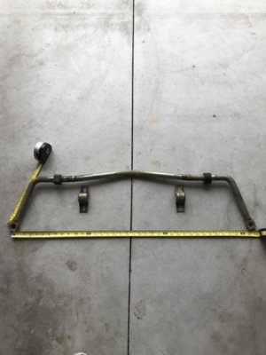

Believed to fit a Mopar since I bought from reliable Mopar guy, but both of us unsure what they fit?
Any input very appreciated and or how I can further try to identify these, can’t find any stamping

Those are aftermarket, probably ADDCO.
The one with the mild hump looks similar to a 70-72 B body front bar that mounts through the K member. It could also be a 1973-76 A body front bar since they are similar to a B body 70-72. I don't recall the difference in widths between the two chassis.
Rear could be a generic that could fit almost any B body from 62-72 and any A body 60-76, any F-M-J-R with different mounts for the specific application.

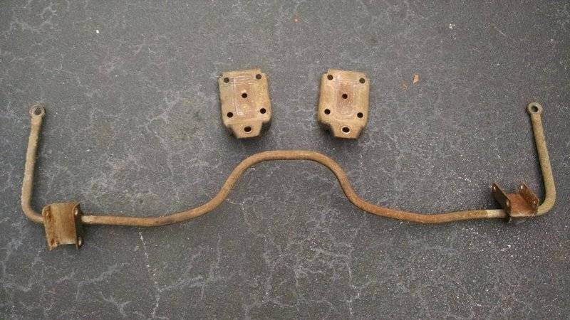

The rear one is definitely not B body... Looks like a 70-4 E-body as they have that big loop.. Unless aftermarket did something stupid. This is an E-body below..
This is 72 B-body below.. They are straight..
Thanks Kern, with this info I’ll see if anyone could use them cheap, the rear also has some clamps, ubolts and brackets also
Appreciate your help
Bill

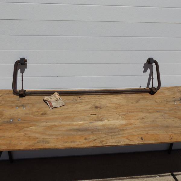

post 3 looks like aftermarket 71-74 B rear
I've seen both straight and "saddle" made for the 71-79 cars.
factory even has both styles.
1979 Chrysler Cordoba,300.Factory rear bar.

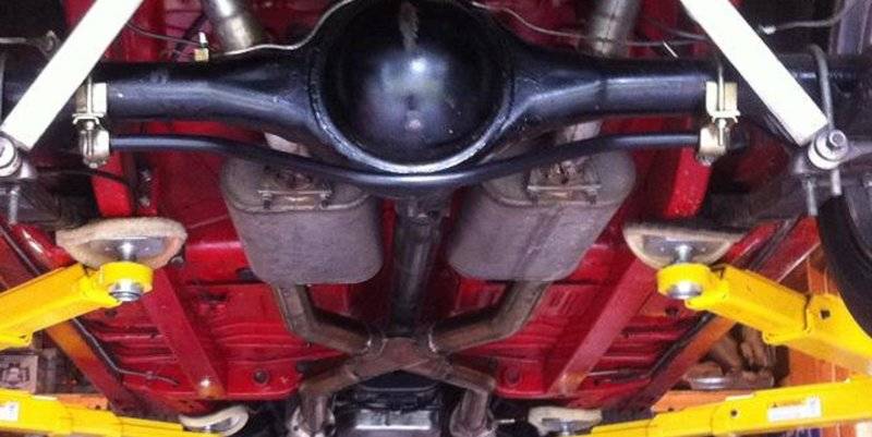

The ADDCO rear bar looked like THIS.
1970 Charger:
ADDCO ships their bars with a gold paint finish. I sprayed this one black. This generic design fits many models.
I am not too familiar with the after market universal fits all stuff... Looking at the pic I still say resembles more like an E-body but who knows I guess with enough rigging you can fit it on anything...
I saw the gold color on the bars and went right to thinking aftermarket.
