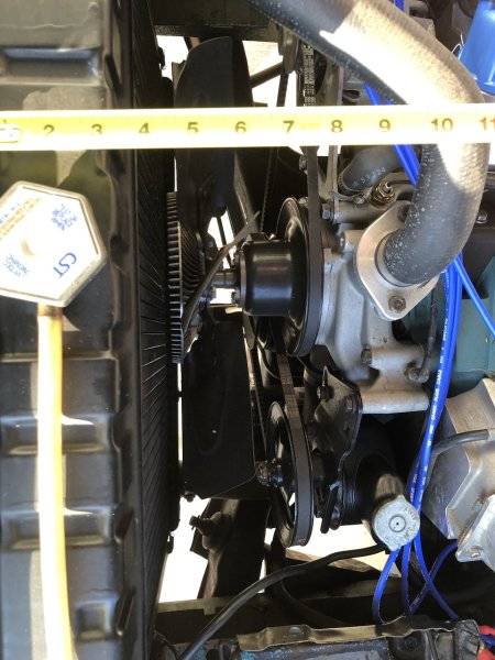

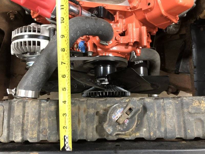

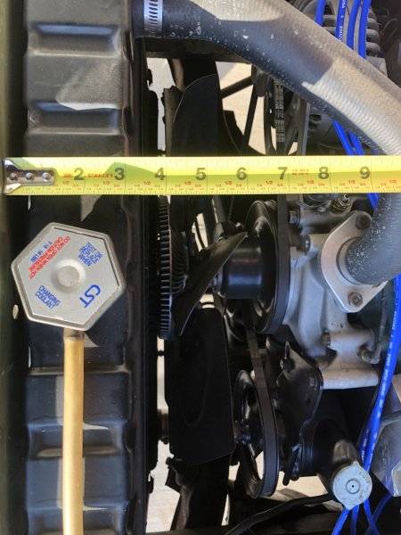

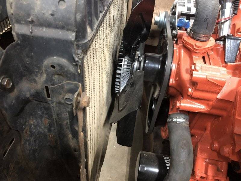

I had to use the (I think) short Jaguar fan clutch (2765) in my 1970 Roadrunner with a 22" radiator and 2863216 fan. The 22" radiator is more than 3/4" closer to the engine than the 26" radiator in my 1968 Coronet. In my Coronet, I used the standard thermal clutch (2747) with a 2863216 fan. In the last 2 pics, you can see the difference in the shaft lengths on the 2 clutches (no spacers are used with clutch fans). Can't help you with the shroud though, I haven't fit either of my cars with one yet.

WHY NO SHROUD? The third pix shows the shroud mounting tab. Once again, the Hayden clutch prevails vs the Mopar TORQUE DRIVE clutch # 2806070 .....is it's cost the consideration? Why not bite the bullet and do the job correctly by installing the correct core support and the # 2998956 26" radiator with shroud and the correct fan clutch......????....

I'm still working on the cars. I haven't even fired up the Roadrunner's 383 yet, and I'm probably gonna swap cams in the Coronet. I have the old 22" radiator installed in the Roadrunner for break in and to catch any rust/crap from the engine. Then I will swap in a new radiator. I have shrouds for both cars.
