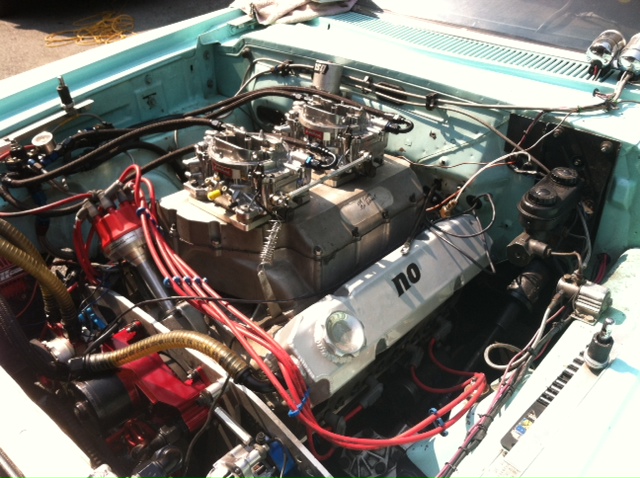

What gasket maker are you guys using on the top plate of Indy tunnel rams?
On my Indy cross ram I use the grey GM RTV. Be carefull,it will be difficult to remove. I cut a .060x.500 slot between the half so I could get them apart.
Doug
When I have to seal my Indy 440-25 crossram, I have had great success with "the right stuff". Other silicones have broken down with race gas.
I agree with Chris. Not all types of RTV work. I've tried others that stayed gooey as well.
