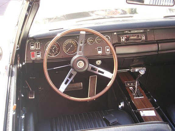

There are differences between years and models but basically in a B body, the Rallye dash contained round spedometers and 'pods' for things like clocks, tachometers and guages instead of the long style speedometer. Availability of the dash varied by year and model. Rallye Dashes were standard in 68-70 Chargers and Super Bees. Optional in the Coronet R/T. The trim varied by year. Some came in black plastic, some came with wood grain.

Here's an example of a Rallye dash in a 69 Coronet R/T. This would be typical of the 68-70 Dodge B body style.

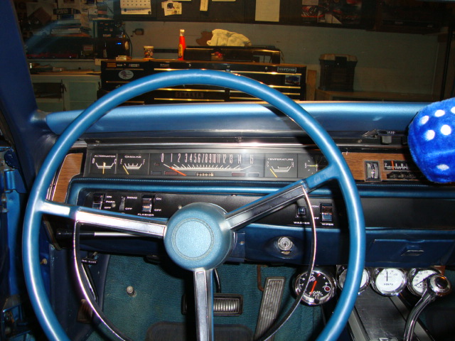

non-rallye cluster in my 68 GTX
