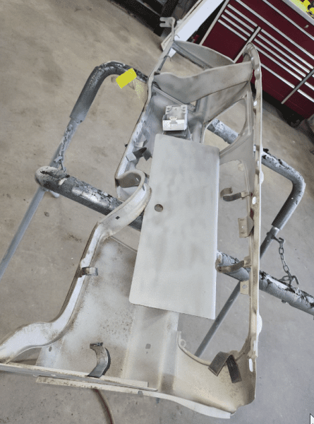

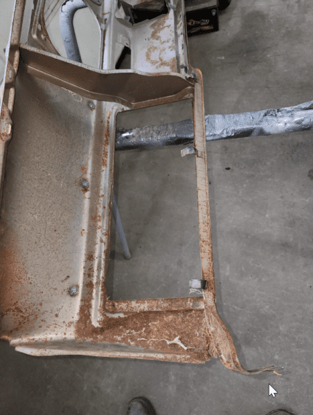

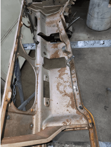

I bought this Dash this summer

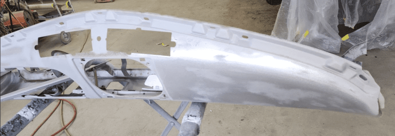

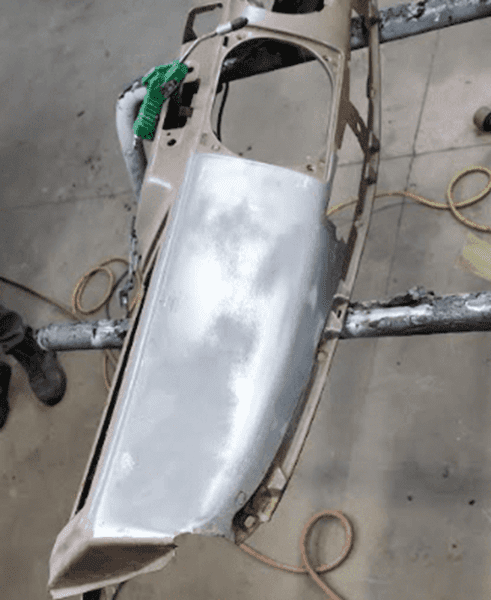

Here is it getting prepped
The same as it was before you sanded it. By the looks of your pictures.
Somewhat of a semi-gloss, so as to limit glare from it.

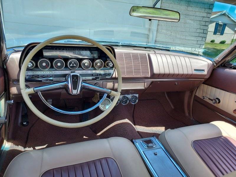

Nope, just single stage enamel. They weren't worried about glare in 1962 or they wouldn't have used a wide chrome trim all the way around the inside of the windshield.

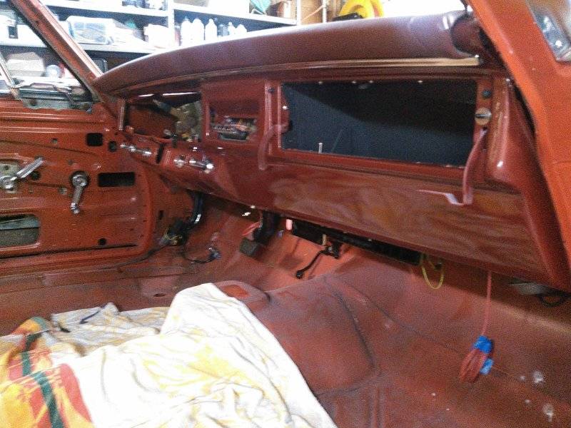

I went with a base coat clear coat.... the issue I had was getting the correct color mix. the color coat is the key..... most of the resto mod guys shoot it the body color. I went the same process as you .... removal .... blast ... refinish. Be careful shooting the speaker slots ..... paint build up issues. My 65 was brite red body .... red poly trim. .......But if i had to do it again ... I would go with Khryslerkid post .... single stage.​

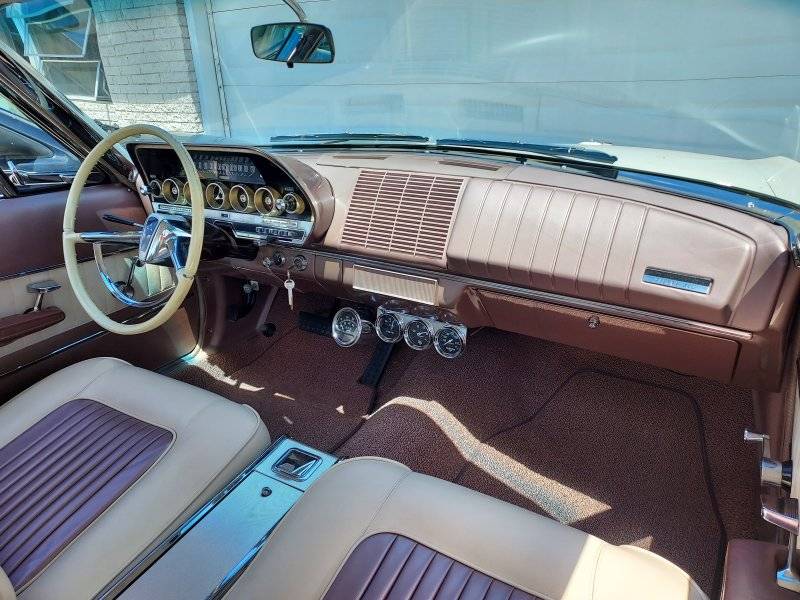

My original '63 was semi gloss, and no chrome trim inside, all painted. Era correct paint probably was ss enamel, as KK said, but wasn't glossy, could have been time faded...

kk, you've got a Beautiful '62, and a Higher End Model, so Better methods may have been used also, compared to my "lowest model" available ? Either way, We're trying get these Relics back out, and Enjoy 'em, before the game ends !!!
