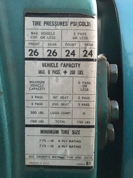

Yes I know what the max rate means which is why I dont have them at 50psi but the door jamb lists the pressure for the stock sized bias tires which is too low for modern low profile radial tires.
30-32 cold would be my starting point. With such a short sidewall they will have a firm ride regardless.
Don't use 50+ year old inflation pressures. You want to drive a modern tire on a 4000 pound convertible at 24 psi? 69 coronet sticker below
