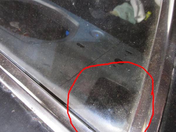

What is this hole in the package tray for?

This is on a 72 Charger.
Roll bar. They were thinking about the racers.
Acutually it was just the way they were stamped. Could have been an aid in body assembly to have that access like to the trunk hindge area. Never seen an option that used them.
Does kinda look like the assemblyman needed to get his arm up past the elbow to hold the speaker and run the nuts on with the other hand lol.

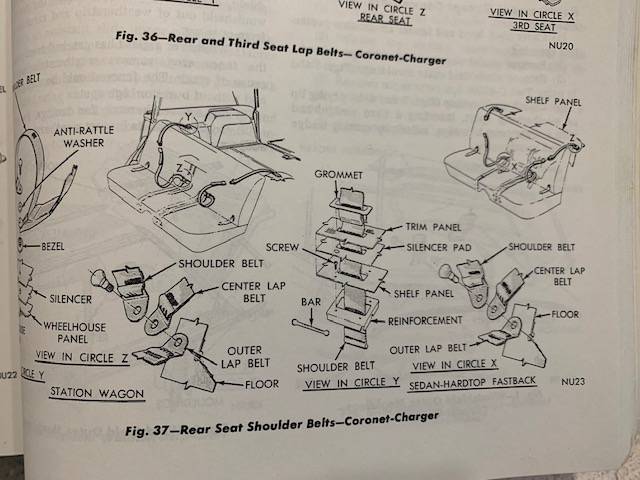

I dug around some more and found this thread - Link
The rear shoulder belt option is indeed real, but the hole I have appears to be too far back. I also don't have the peg in the trunk that the belt anchors on. I'm not sure how that works, I'd like to have a better pic of that peg to see how it attaches to the trunk. I'd like to have pics of the rest of the shoulder belt mechanism too, if there is a mechanism. Given how basic the front shoulder belt was in 72, it's likely the rear shoulder belt is also just a strap hard-mounted to the car. I think I've seen a modern retractable shoulder belt conversion, but I couldn't track anything down about it.
Been looking around some more and found these threads - 1, 2, 3.
It appears there were two different solid attachments and one retractable shoulder belt. And the version that went to the peg in the trunk that I posted previously. That's a lot of different versions of a very rare option.
Looks like the shoulder belt slot was removed for 72. One can only imagine why, but it looks like I'm S.O.L. on this one.
edit - I've been looking at Cordobas to see what they had - I can't find a picture of one with rear shoulder belts, even in the early 80's! Puts some perspective on the late sixties shoulder belt option. It's not as exciting as a HEMI, but it's nice to have. I've seen a few B-body owners put the rear shoulder belts in because they're concerned for their kids/grandkids safety. I'm a little jealous that my newer car can't have a shoulder belt (without more fabrication than I can do).
