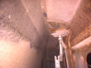

What is this? Not hooked up.
Dad's69RR
12:18 AM
Mar 13, 2014
227
86
Powell, Ohio
At the bottom of the window slide there is a post and nothing is attached to it? Both windows roll up and down easily and I cannot figure out what they are for? Here is a picture to help understand. Sorry it inserted upside down! Inside door post.JPG
The piece on the door broke off the window channel. Mine did this too. Have not fixed it yet.
Mug Weld with.025 wire on a very low setting with a friend holding it to keep it in place. Do the other side too. That makes the rattle when you go over the railroad tracks go away...
