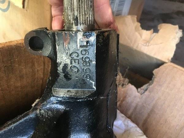

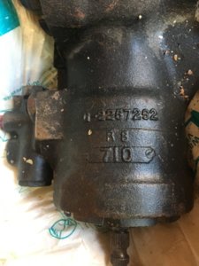

What is this steering box from?
2:26 PM
Aug 9, 2016
17
0
Winfield, ks
help please and appreciated.
I'm unsure how to read serial #'s.
Images attached.
if you write the numbers I can try to look it up
Dave. Thanks.
It's B 2267262
Under is stamped R8
And then 710 below that
On a separate spot below these is:710
There's another spot I see numbers. And they are 169898
With CEO under that.
You can verify locations by looking at the pics if it helps.
Hope you can tell me something. Thank you.
Mopar Power Steering Gear Box G-2267262 Date Coded "1020" - B & E body Late 1970
