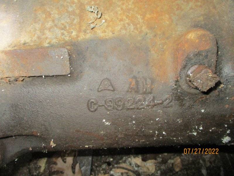

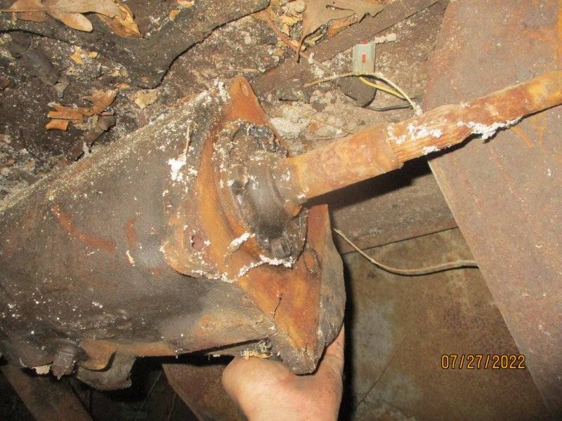

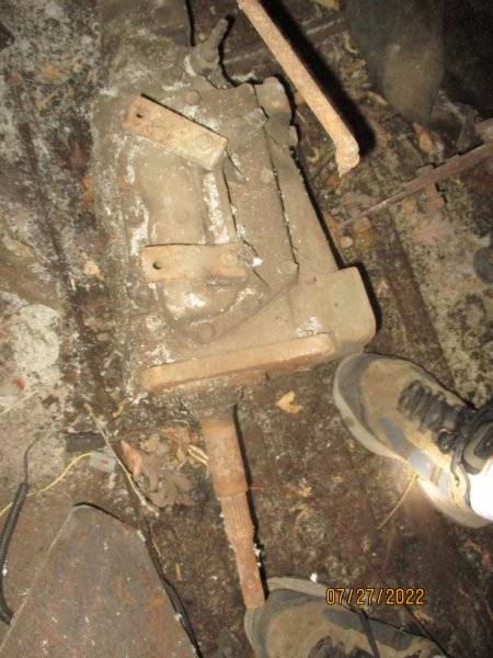

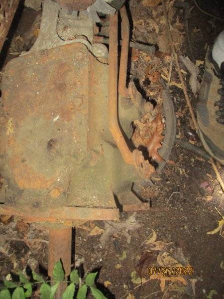

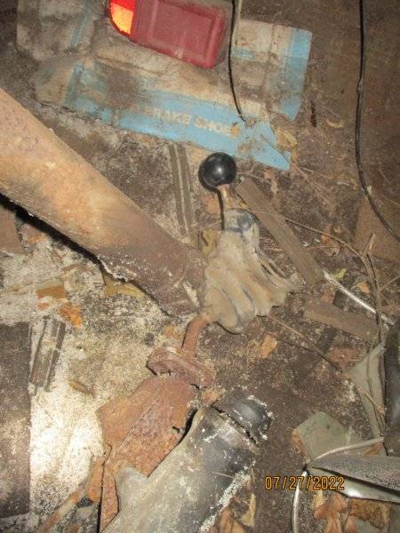

Hello, trying to identify this transmission what type and what it may have come out of. Any help appreciated.
Thanks,
Wizard
No 3rd lever for reverse tells me it's a 3 speed Heavy Duty Mopar.Don't know the number.
Had one in my 1970 340 Duster.
The light duty is A-903 and has a top tin plate.
Mopar A230 3 speed manual transmission C-99224-2 Dart Duster Valiant A-Body 3:1
Just put this number C-99224-2 in Google and this comes up, along with a picture on E Bay. Mopar A230 3 speed manual transmission C-99224-2 Dart Duster Valiant A-Body 3:1 | eBay
Thank you, sir. Yes. I see the E-bay one with the same number on this one on the case. Appreciate it. Also has the shifter attached and the rods so it is a 3 speed for sure heavy duty. Thanks to all.

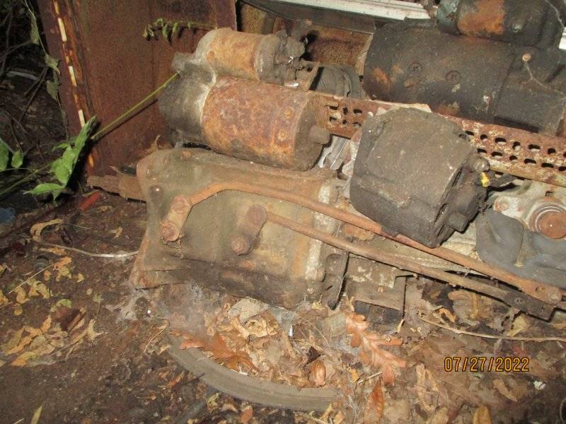

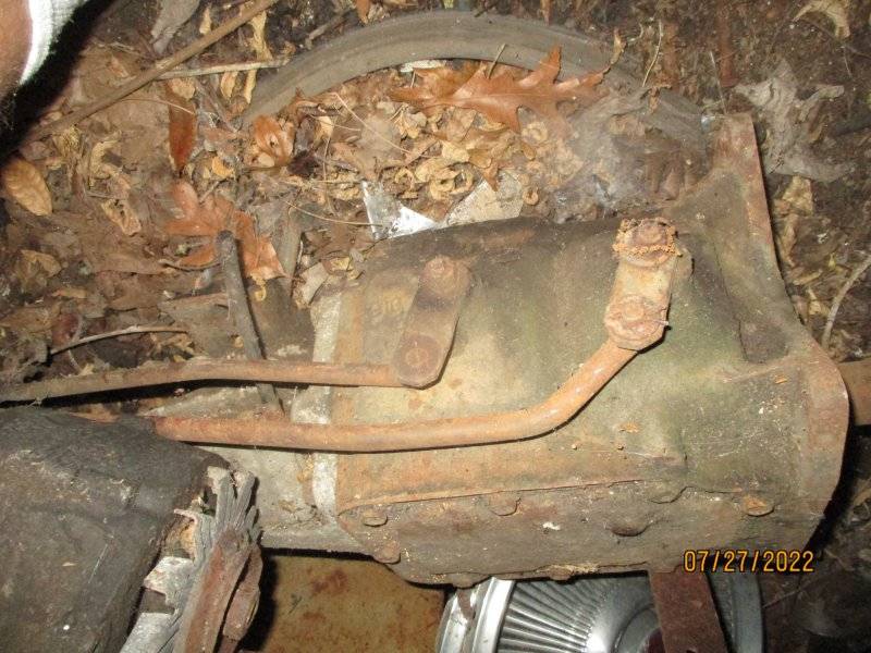

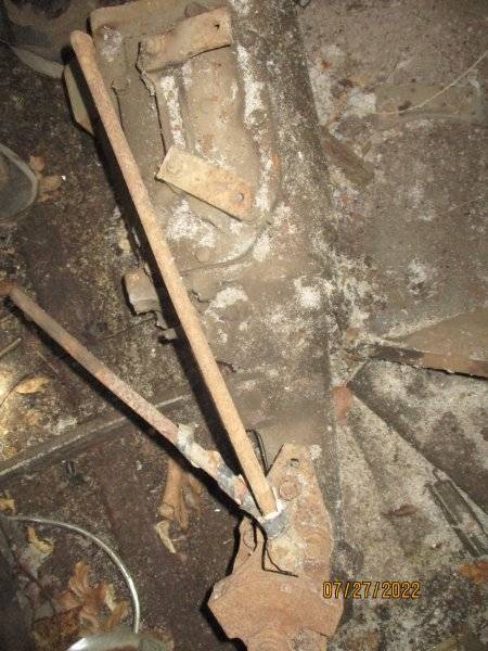

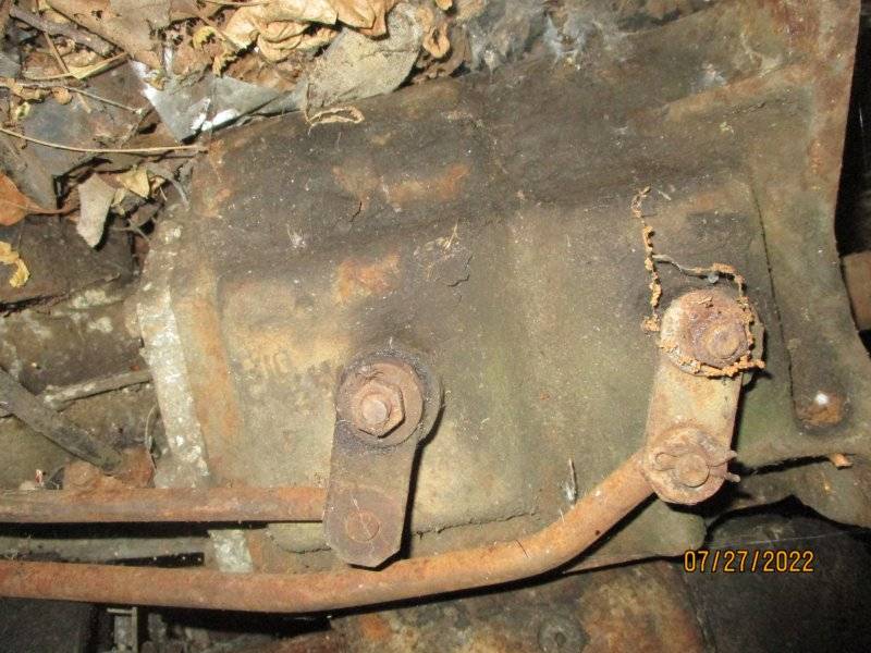

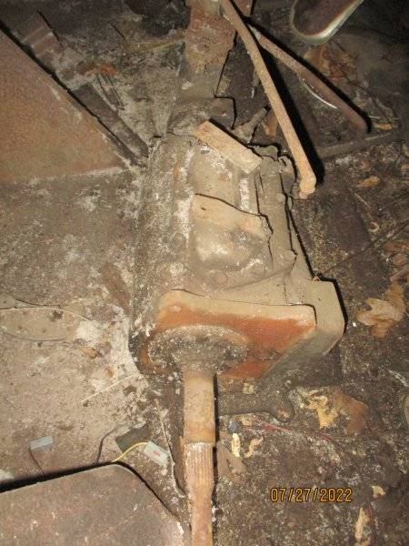

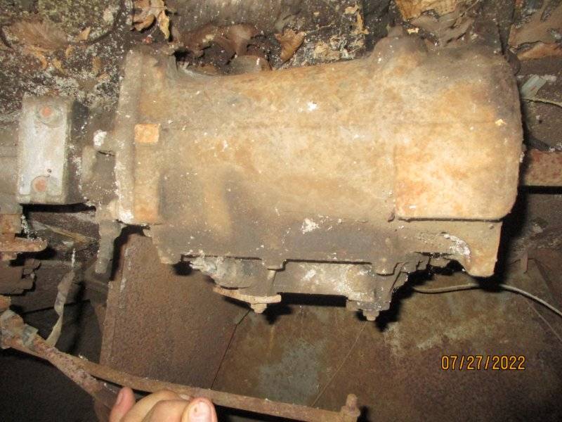

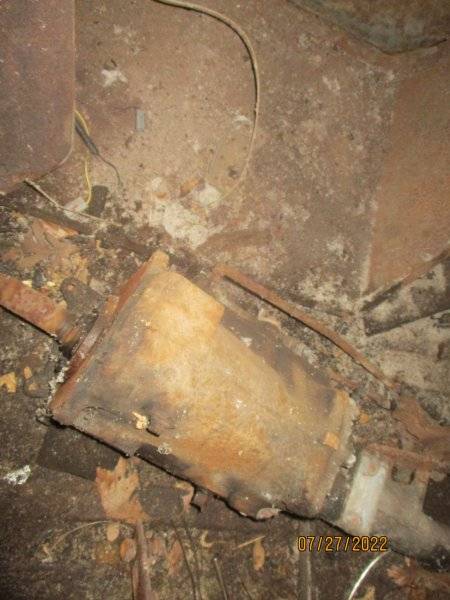

How about this other one that I have? Any ideas what it is or what to?
That's the A-903 tin plate top that was light duty.
