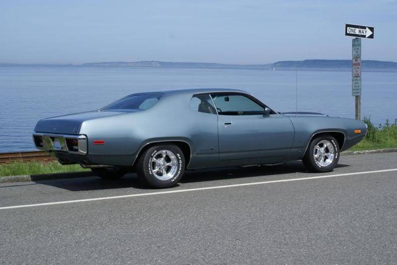

Assuming your original springs are all sagged out, the XHD's will make your car sit several inches higher.
Here's some MP XHD's after settling in, with gas-a-just KYB shocks.
right now, previous owner is using adjustable shocks to change the ride height. so the rear sits really high. he did this so that the tires wold have clearance..the tires are only 265's though..and they would rub if the shocks weren't holding up my car high enough..
so i'm hoping that if i get the xhd's and kyb's, the height will be good enough for tires to clear!
thanks 72 runner for that pic. looks like a nice stance..not quite as high in the rear as mine sits right now, but hopefully if i get the xhd's, i'll have enough clearance..
