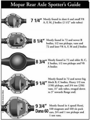

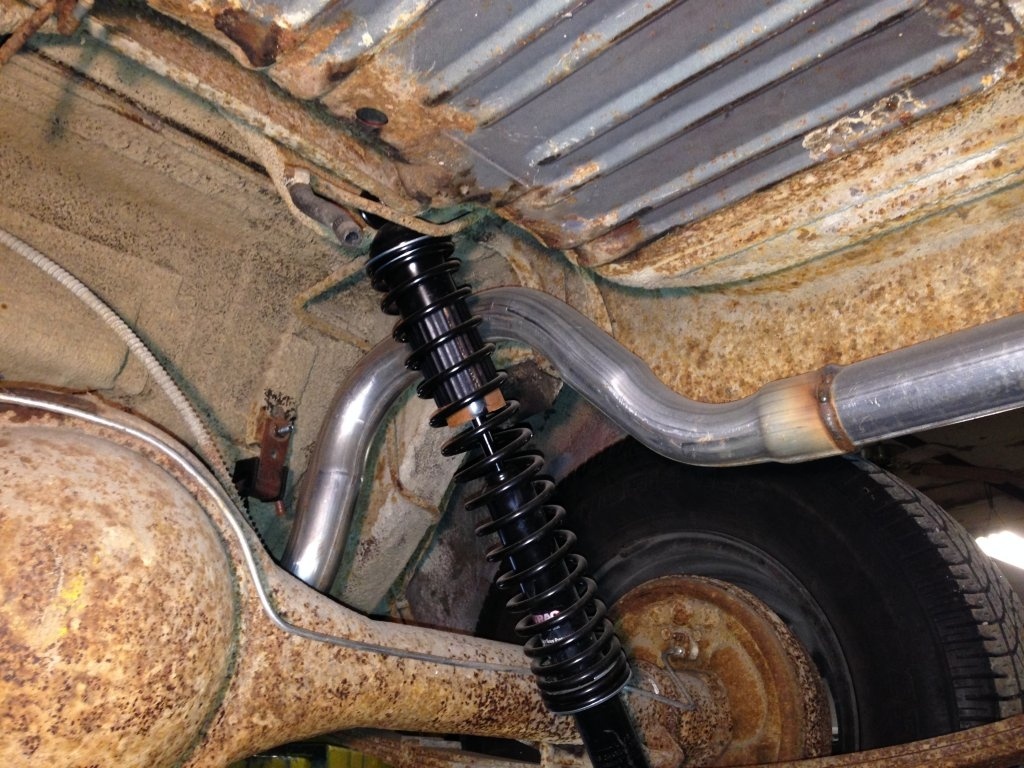

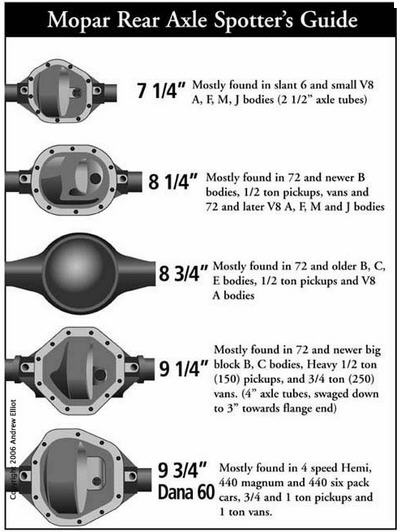

Hello Everyone,
I was told by the previous owner I have an 8 1/4 rear end in my car I just bought. I did a Google search and found an image that shows 8 1/4 rears with bolt on inspection covers on the rear and it shows the style I have as an 8 3/4. Can anyone tell what it from this picture. The fender tag was missing and I'm not even sure if it is the original rear end anyway. The vin says it came with a 318. According to the Diagram picture I found and posted here, It looks to be an 8 3/4 to me, but I'm new to Mopar and have a lot to learn.
Thanks for your help ~ Lenny B
Yep, I had a '73 Charger 318, 904 trans and 8-3/4" though my '71 only had a 8-1/4" with same engine/trans.
The 8-3/4" rear ends like Lenny B has are MUCH stronger.
