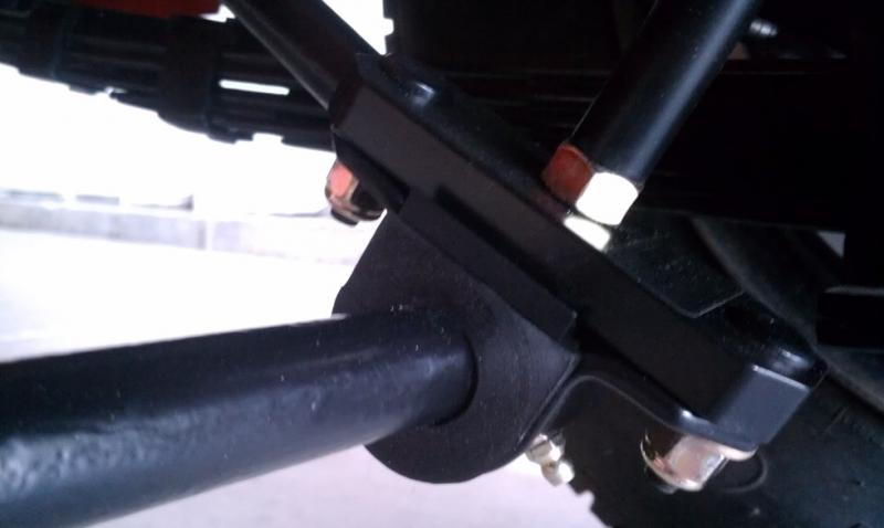

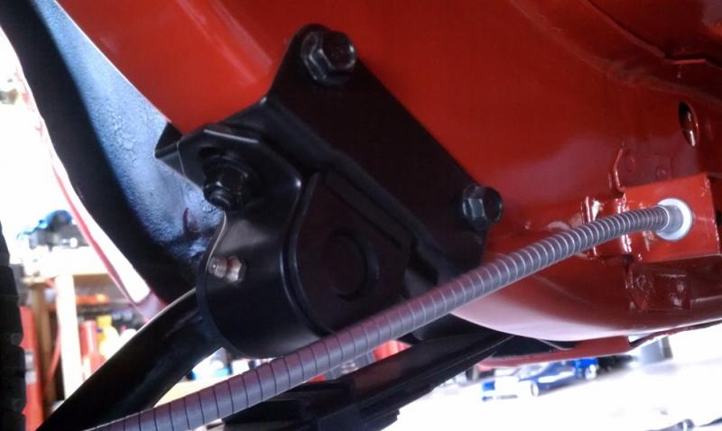

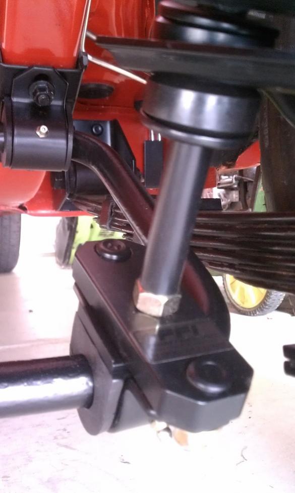

For the rears, I got a kit from Firm Feel, they are pretty stout, but I had to shim the bushing on the bar to body mount and the bar itself so it would snug to the bar. They are all urethane and come with grease fittings so you can lube them if they squeak.
Thanks for posting, especially the very clear pictures. Was it a straight forward job ie no pressing of bushes required?
