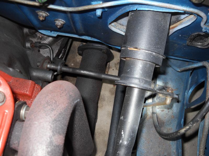

I have Hedmans. My engine builder gave them to me. I had them blasted and painted a couple of years ago and the paint is pretty much gone now. As far as the linkage is concerned, I did a 180 on everything with a bit of modifications. The linkage is now on top. I saw an offset linkage a long time ago( I think on E-bay) but I haven't seen one lately. The modifications that I did have been working fine, so I might just leave it. I also had to take steering link apart.
