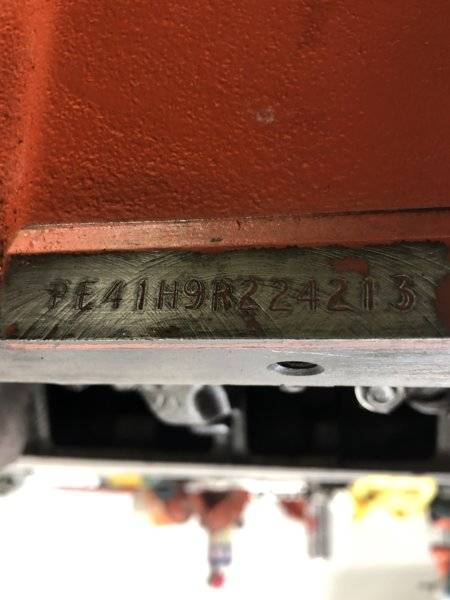

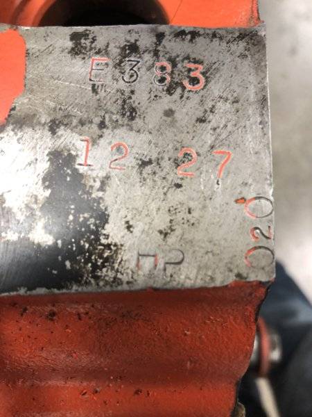

So I bought a motor Ina package deal. Now that I’ve had a chance to look at it is:
Out of a Windsor built 1969 fury 4 door. And it’s a factory 383 HP motor. Who would do that or is this maybe a cop car? Only 7900of these made that year, who knows how May could have come with the 383 HP motor! It was manufactured dec 11 1968.

Having a 383-4 is not the point. There wasn’t supposed to be a C body 383 HP assembly like there was for A and B bodies. All C bodies were supposed to have the low power 330 horse.
Linking a C body to a 383 HP assembly is fairly interesting.

This is what I was kinda thinking too. I would like to know more about it but I imagine no one kept any interesting records on this one. I wonder if it was special ordered for government or police service etc....?
PE-
Economy?
Does it have A38 on the tag?
PE is the first two didgits of the vin. It means Fury I 1967-1971
I don’t have the car (thank goodness) just the engine
I parted out a 69 Fury III cop car with a 383 4-bbl. Was painted blue and was not stamped HP but had hp exhaust manifolds and the hp unsilanced air cleaner.
