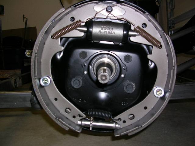

I'm pretty sure my '68 GTX has this set-up (or similar) - it's fairly easy to spin the adjusters from behind
using a flat blade:
The spring is what holds the adjuster in place by friction pretty much...

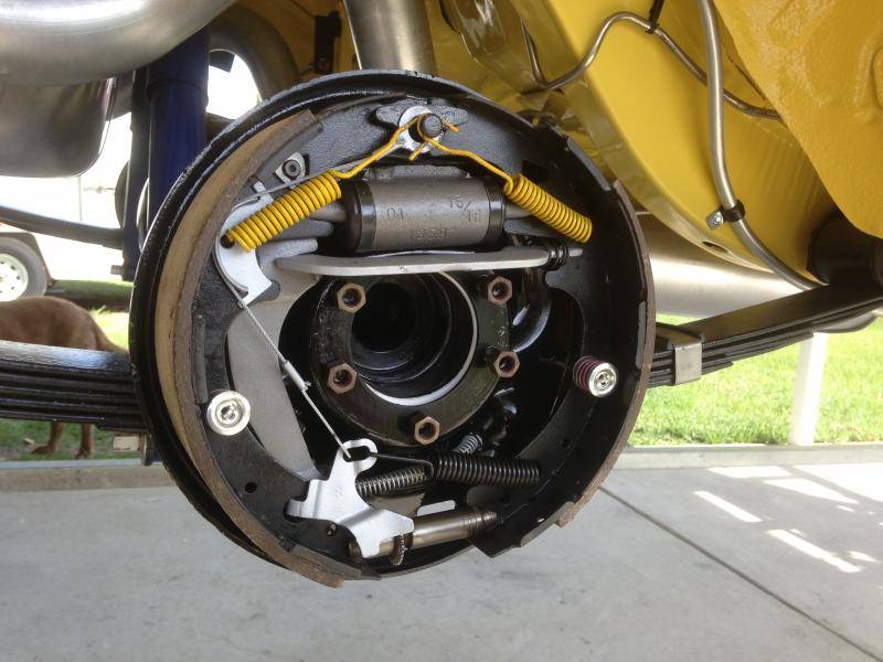

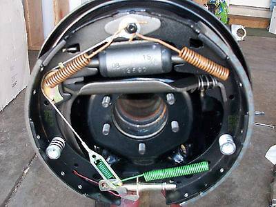

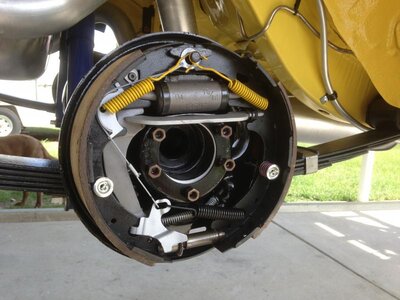

To quote Rick: "The adjusters were totally redesigned for '69, no more over-adjustment. WAY better."
I don't know which one in my case, but he must mean like this:
Or maybe this?
I need to do some more research, obviously....

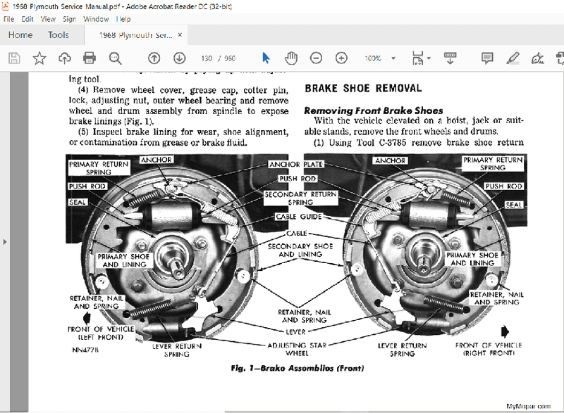

Nobody else have any input on this? Ok... I'll just post this for my own edification then.
From the 1968 Factory Service Manual:
"The new models have a self-adjusting servo contact, two shoe, internal expanding brake.
The lower ends of the brake shoes are connected by a tubular star wheel adjusting screw (fig. 1).
Police cars with heavy-duty brakes are not self-adjusting."
This would appear to indicate that all '68's had self-adjusting brakes except cop cars?
Also from the '68 FSM, here's the illustration of 10-11" drum brake hardware/installation:
The rears look just like these, too...
I reckon that solves that - the '68's had self-adjusters, just not the kind with the spring-loaded gizmo on the end of the adjusting cable.
