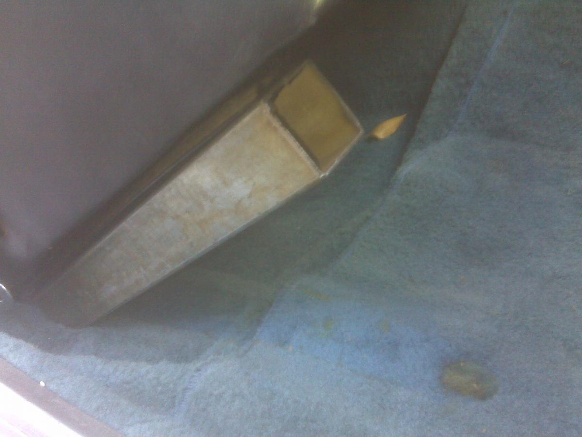

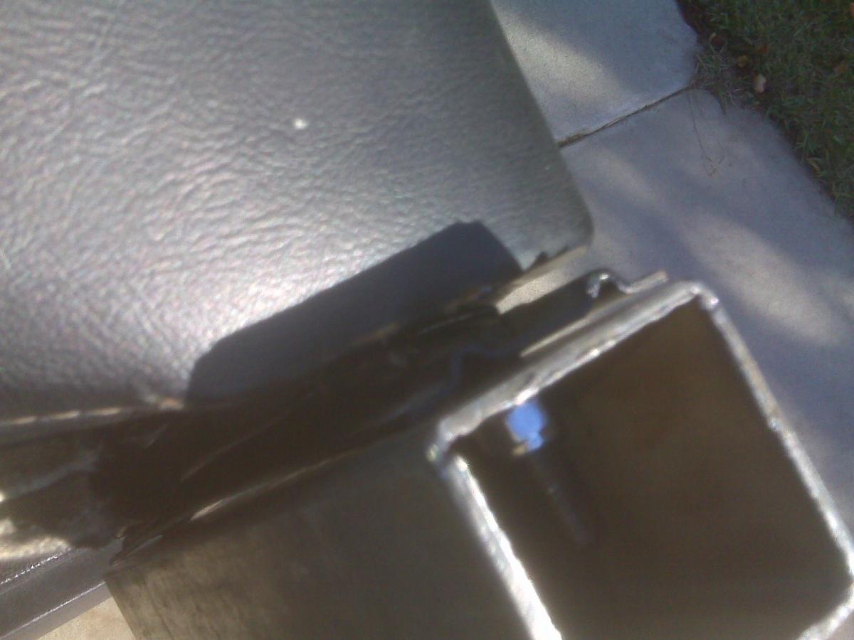

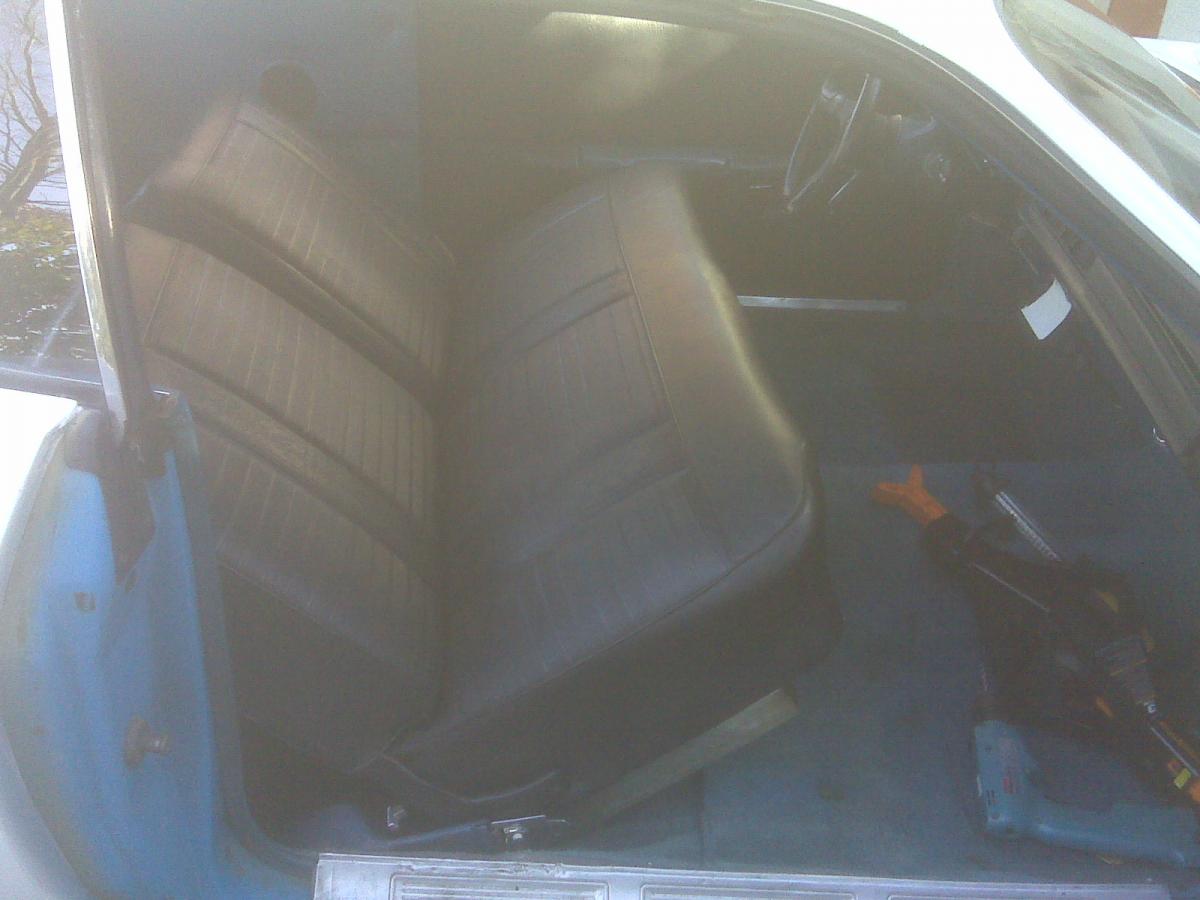

just an idea. I took a seat from a 67 A body(my dart) and put it into my satellite.
I had 2x2 square metal tubing that I bolted onto the bottom of the my seat, then I set the seat right where I wanted it. and bolted it to the floor. this only required drilling 4 holes in the metal tubing.. only "downside" to doing this is that it raises the seat's height 2 inches. It is definitely noticeably taller than stock height. but isn't too tall.
good luck finding your seat. I will post pics of how I did my seat if you want later..
heres what I did. and it works pretty well...figured it might be an idea for you..

I cant remember exactly at the moment, But i believe the Abody seat was only 1 inch shorter than the B-body seat. which meant tat I needed to change the bolt pattern inwards approx. a half an inch on each side.
