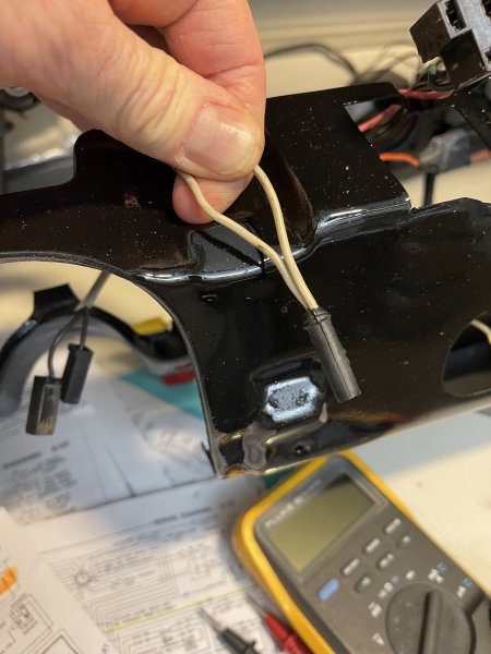

Duel white wire to single female. Can not locate on the schematic. Any one recognize where this goes? It is a ground or at least terminates to a single white wire that looks like a ground lug.

What type of car? Is it connected to the dash wiring? Is it connected to the engine wiring?
1970 Sport Satellite Belvedere dash harness.
Probably the ground connection for your courtesy lights......ceiling light from door switches.
....or single white female with 'dual' whites attached sounds like it belongs in the Blue Forum.
****duel is two guys with pistols at dawn in a lonely dew ridden pasture.
Could be multiple possibilities depending on application and options your car may or may not have. Power top, power windows, rear window lift [wagon], headlight on buzzer, etc.
:lol:
Where does the other white wire go from the dual connection?
I see 3 white wires, none with a screw on terminal,
a white from TS switch to brake switch.
a white from wiper switch to washer switch.
a white from rear defrost switch back to fan motor.
Dome lamp and jamb switches are pink and yellow wires

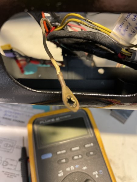

Two white wires are tied together to a single connection as shown. They go into the harness.
The single white wire with circular terminal as shown goes into same harness and are shorted as in the sane node.
Pretty sure those wires are for power window option. Does your car have PW? if not, they are likely not used.
Thanks no power windows. If they are needed I’ll see whats not working lol. They are the only wires I couldn’t identify. Thanks again!
Ignition switch light ground. One wire goes to to drivers dome light switch and the other to time delay relay. Should have been yellow with tracer stripe. Only used if you have the A01 light option.
