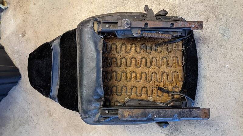

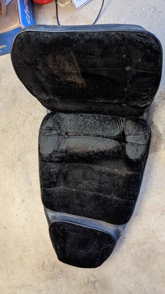

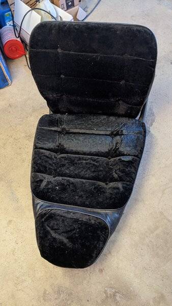

What year/model are these seats from?

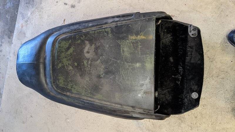

looks like 72+ B body or perhaps something later like a Cordoba or something.

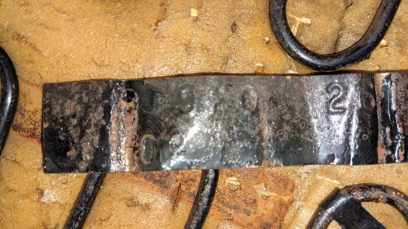

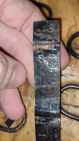

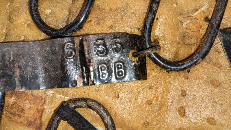

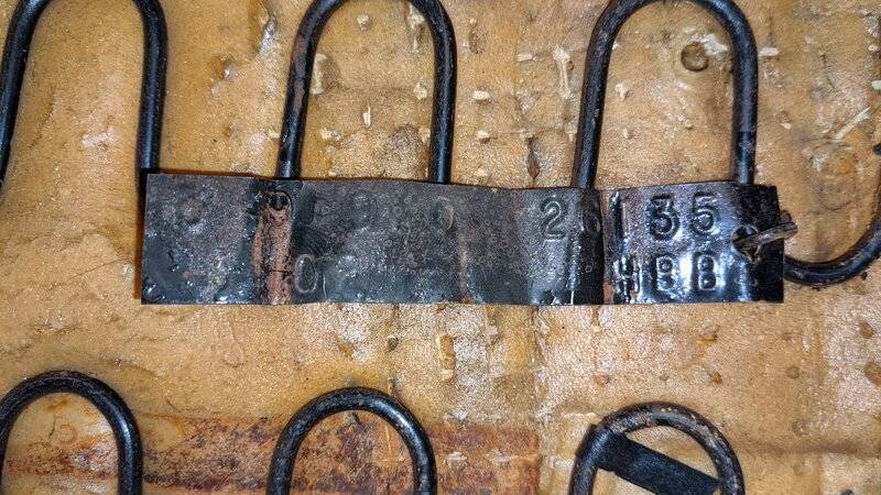

Is there a thin metal tag attached to the bottom? That would give you a date code.

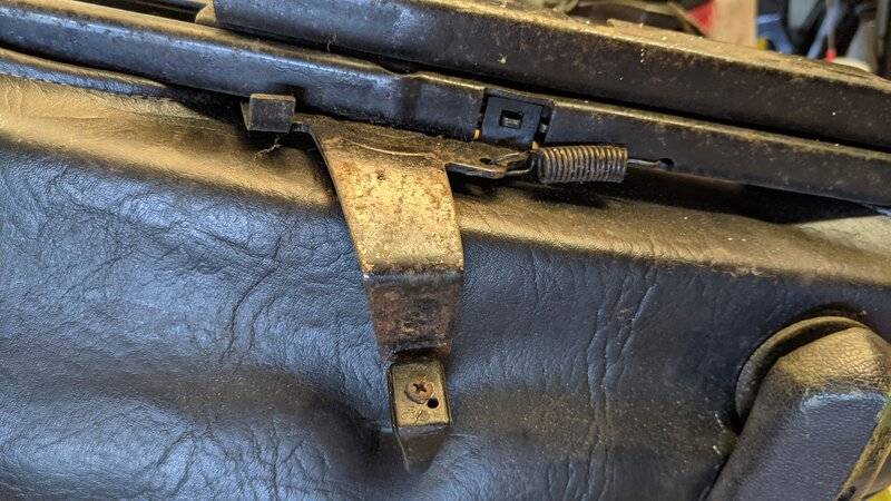

Tracks.
I do need cores and tracks for my 72 Plymouth, that was primary reason for grabbing them
I have a 73 Roadrunner and the seats are identical, even the black paint over green plastic backs. :)

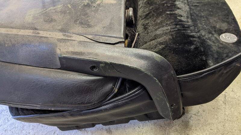

Lates B bodies ( Cordobas ) are with more cushioned covers and three buttons rows.
They are 72/74 B
If back release button is colored, it is in fact 73/74, Chromed would be 72.
There is a diff between 73 and 74 about the cover vinyl grain pattern too LOL.
Weird it doesn't have the weight sensors. Althought some 74s didn't get them on driver side. I think laters.
I can see on the close up pics for the tags the foam got the shape of a seat weight sensor molded in, but removed. And the other pic being driver side without any mark, SOOOOO it could be late 74 B body buckets set.

Are the tracks the same 71-74?
