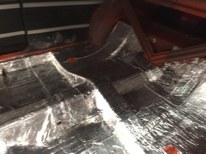

I went ahead and used your method ODZKing. It came out pretty damn good. After a few weeks of fiddling around with some other wiring and so forth, I finally got the interior back in and took the car for a ride. It's not magically transformed into a quiet Japanese car or anything, but it's noticeably better. In particular the Flowmaster drone is much less now with the insulation. And I ran it from the top of the gas pedal all the way to the back where the floor turns up into the trunk. I especially put extra layers over the driveshaft tunnel. Very happy with the results. I used 3.5 rolls to do the entire job. Here's a pic before I put the interior back in.

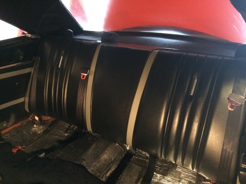

Also I installed 3 point seat belts in the back seat for the kids. They came out awesome as well. You can see the 3 spools on the package tray. Now the kids will be super safe when riding this summer!

Outstanding, I glad you're pleased with the results.
Easy to use and form wasn't? :eusa_dance:
TOTALLY. It cut real easy with a razor and was real easy to work with. I used a rubber mallet to rub and push it into place just to put a little force on it. Using the adhesive backed type was the right move too.
I know removing the interior isn't the easiest job, but it's also not the hardest. This wasn't a big deal. I completed it in a few nights and I think it's made a difference. And I spent about $80 total.
I'm going to be putting a few hundred miles on it in a few weekends for a road trip. I'll know more then.
Thanks again for the inventive idea.
