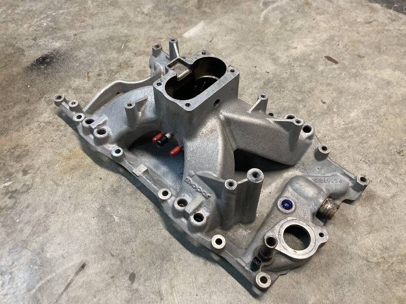

I did all of the bolt on upgrades to mine. Mopar Performance ECU, Mopar Performance M1 intake, Harland Sharp 1.7 Roller Rockers and headers. I never took it to a dyno but the seat of the pants dyno showed a decent improvement. But Since the Mopar Performance M1 intake was a single plane my fuel economy suffered drastically. But Its hot rodding and I sucked it up. The power range was 2500 rpm and up. The low end grunt was gone I installed a turtle into the floor of the M1 intake to help bring back some of the low end torque. It helped a bit but can't give you any actual numbers.
This was the intake I used. I also forgot to mention I installed a 52mm Billet throttle body. Up from the stock 50mm.
This is where the Turtle was installed.
