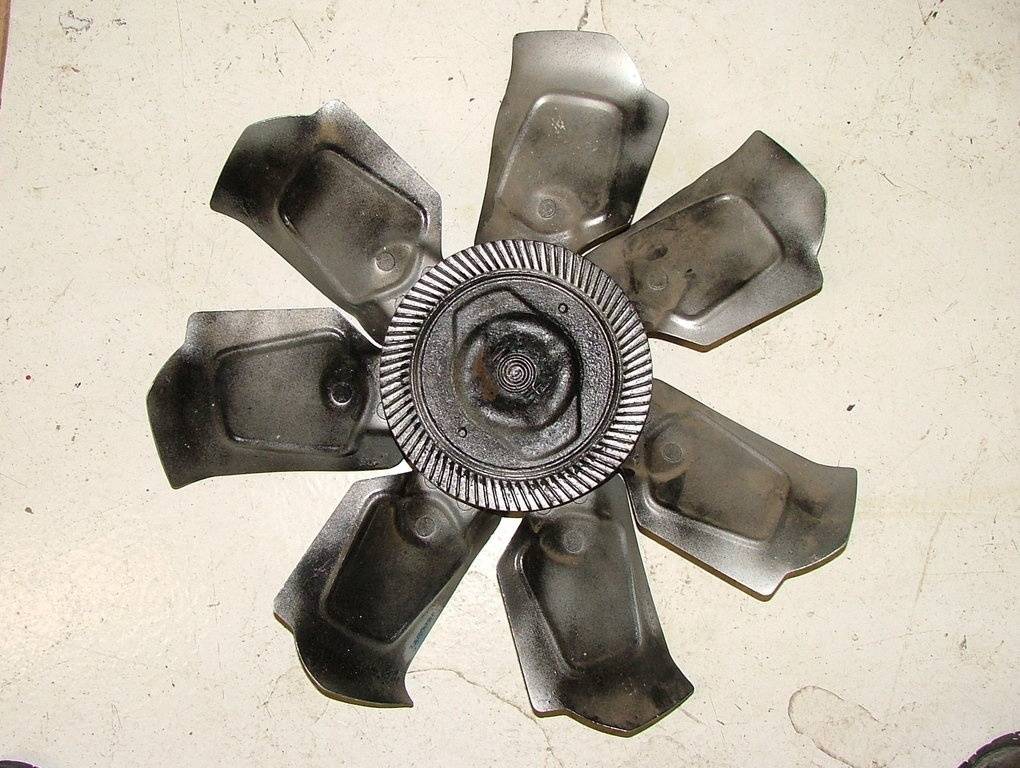

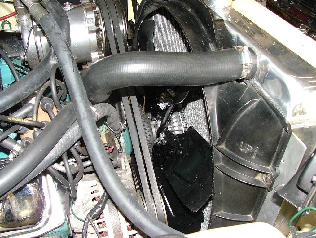

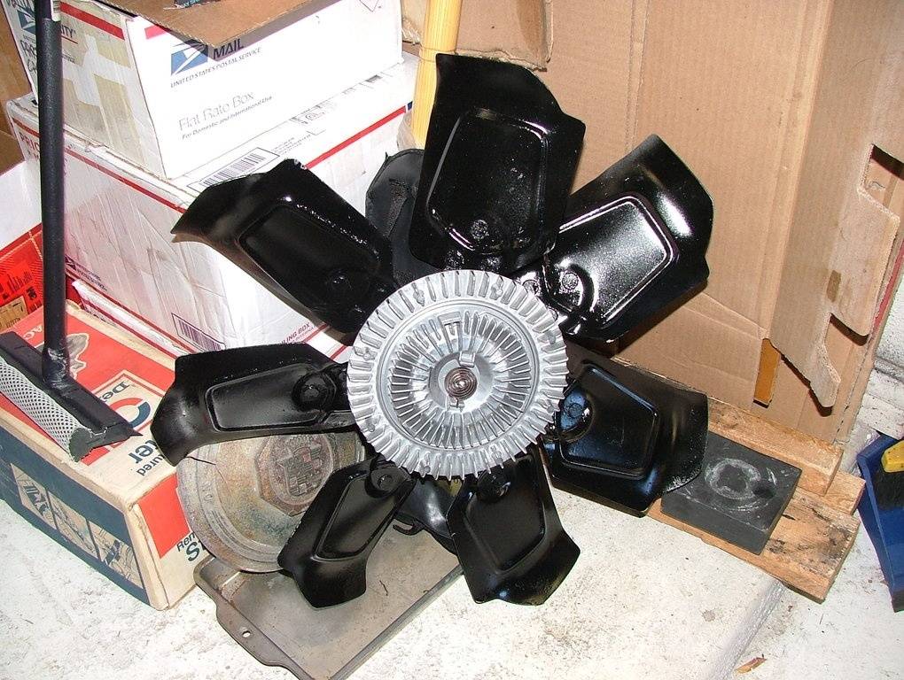

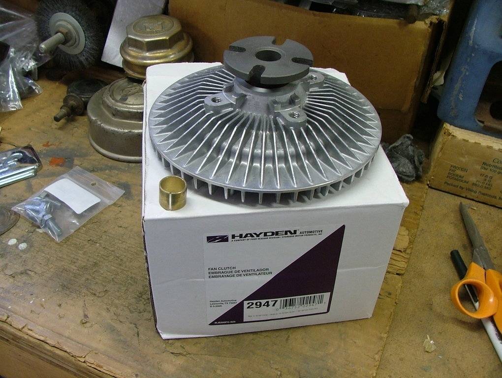

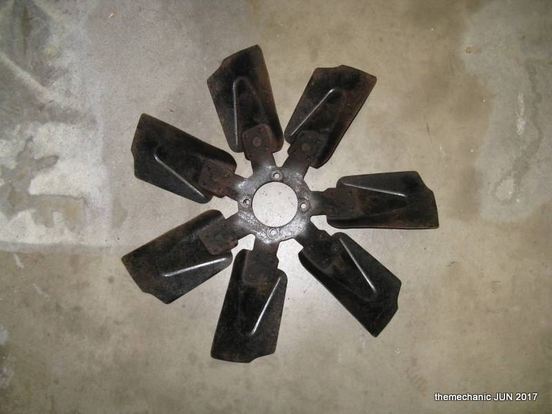

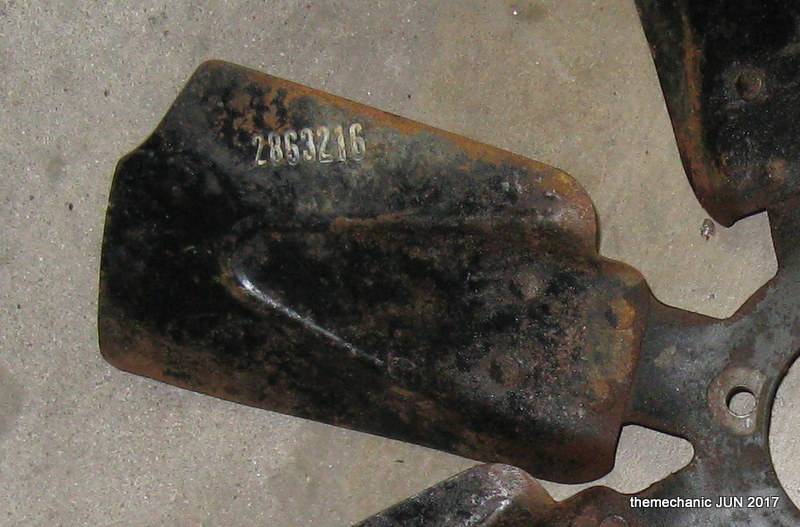

I found a factory 20" diameter deep pitch clutch fan on Ebay supposedly from a 70s 400 with A/C. I combined it with a Hayden clutch and it fit but I also had a shroud with a 22" opening. Made a big difference in cooling my car.
