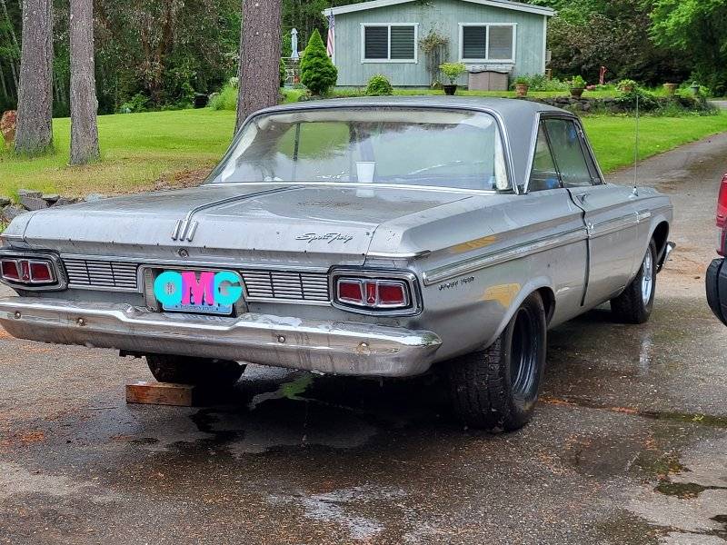

Whats the biggest tire you get under a stock 64 fury

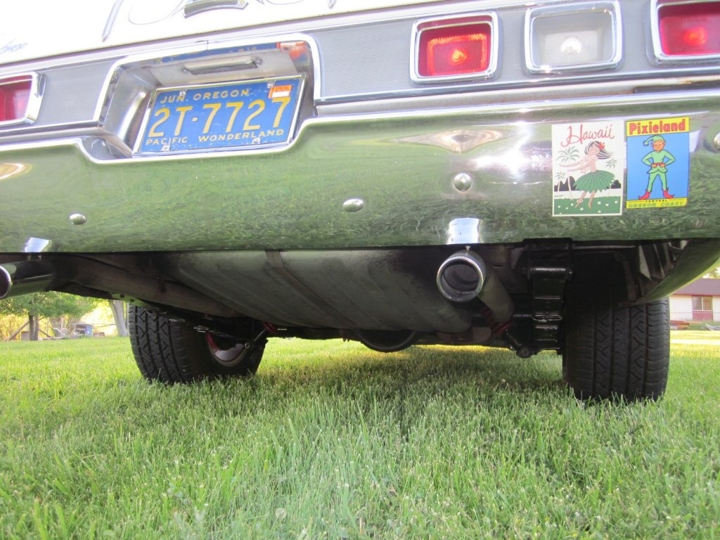

15x8 with 4 inch back space and 275-60-15 tire. Ran that on my 64' Polara 500.
Same here on the same year/model of
car.

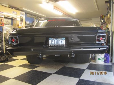

With a mini tub and the wheel lip removed on my 63 I stuffed an MT E/T street 16.5 X 31.

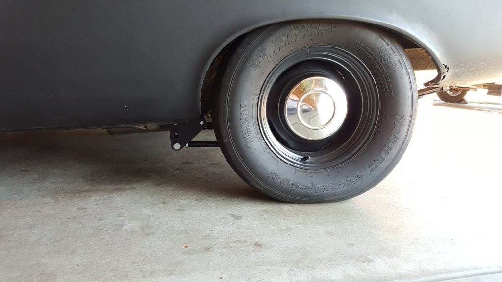

On mine, 275-60/15's w/ 15x8 welds w 4" offset. Still had some room to get a finger on the outer and close to 2" at the springs. Same wheels on the front but 235-60-15 on the tires.

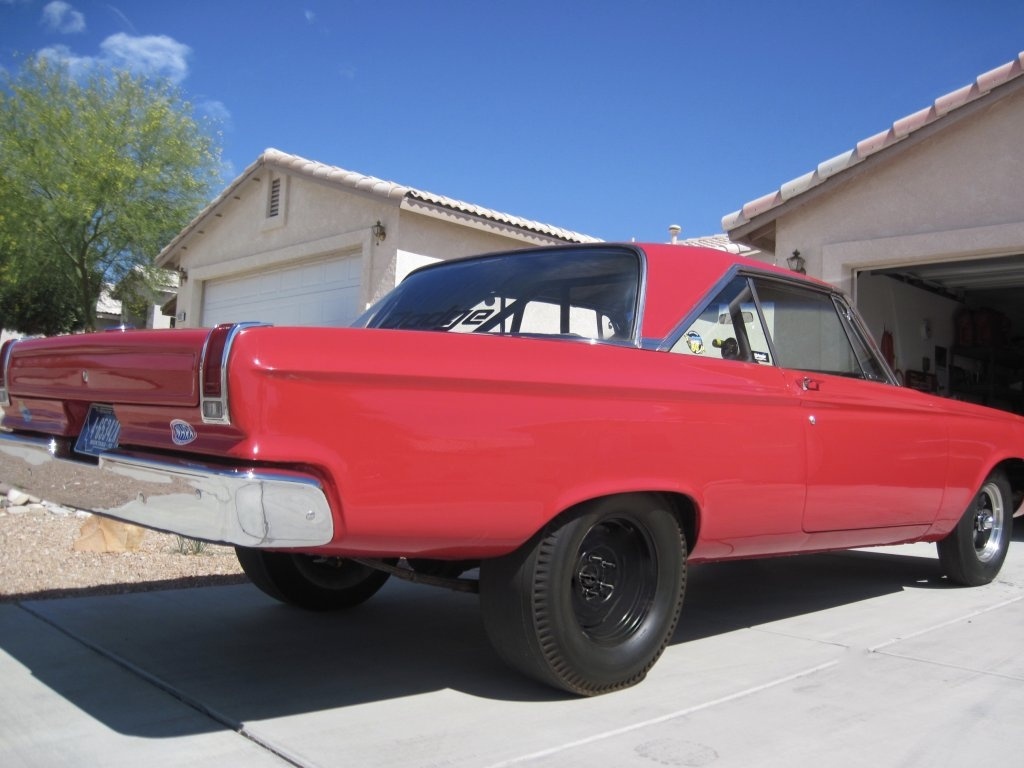

275/60/15 Mickey Thompson ET Street Pro's on 15x8 Wheel Vintique steelies. 4.5" backspace wheel but I'm using a 68-70 B body width Dana 60.
