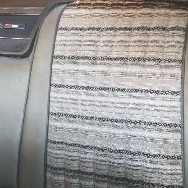

I got a 383 '66 Sattelite with this factory interior pattern. Any idea what this option is called?
Maybe an option never seen it. Be interested to see if someone can identify it.
Are the front seats the same pattern? Pictures? What are first two letters VIN on drivers door. Are they RP or RH? See the Satellite logo between seats.
Mine also has vinyl buckets like Fran's,
Must be a special order of some kind.
Didn't know cloth was listed in options.
What is the interior code from the fender tag, window sticker, or build sheet?
The plastic seat surround is that black or brown?
My guess is that inserts and western scroll were replaced at some point in time. Without seeing the entire interior it's hard to say. My red book doesn't show anything like this. All Satellites had bucket seats up front and I'm showing all interiors to be vinyl and the dual western scroll. If this car is a one owner original, find the build sheet, show the fender tag, and the VIN#. With Chrysler I will never say never, just highly unlikely.
Yeah the front seats are the same pattern but a bit more sun faded, the photos don't do it justice it's a really weird olive green color.
That makes sense, just got the car out and haven't got to the build sheet yet, if there's anything left.

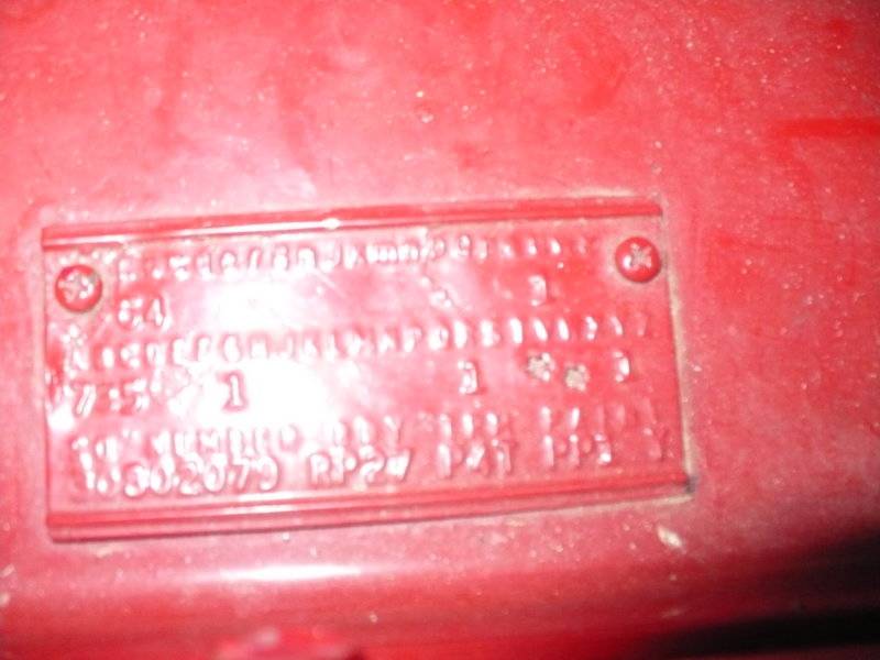

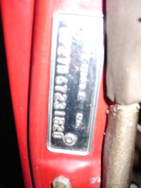

Really need picture of car, front seats. first two digits VIN and picture of fender tag. Fender tag is on flat surface near battery. First pic fender tag second VIN.

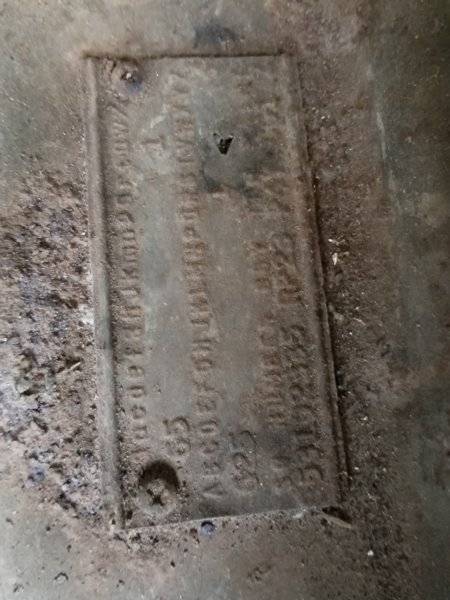

Look under driver's seat, behind rear seat back, under rear seat bottom. These I find these most common. Other options include behind drivers seat back over glove box and under carpet on passenger's rear. I have found in all places that I listed.
Really need picture of car, front seats. first two digits VIN and picture of fender tag. Fender tag is on flat surface near battery. First pic fender tag second VIN.View attachment 913891 View attachment 913892

Here's the fender tag. And it was an RP vin code car. Been busy and havent gotten around to checking on the build sheet.
hmmm
P4 vs P6
