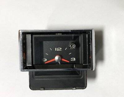

My 67 GTX doesn't have a clock. I recently bought this 66 Satellite and was going through the dash since I had to put a new harness in. I had never paid much attention to the clock since it didn't work and I've driven the car very little. When I removed it to clean it and put a quartz movement in it, only then did I realize you can't read the lower part of the clock dial.
I grabbed this off the internet but mine looks exactly like this one so I guess it's correct. I realize a person is looking down on to the face but I don't think that makes that much difference - but the clock isn't in the car at the moment.
Right??? I guess those Chrysler engineers didn't figure the time between 4 and 8 was important to anyone? Very strange.
You can still tell the time unless you're from a newer generation. I have a niece that can't tell time unless it's in a digital format. :BangHead::BangHead:
Looks like you either have the wrong bezel, or the movement is wrong? You sure you got the right parts?
Once the clock is in the dash you will notice that you can see the entire face of it looking at it from the driving position. It was made that way intentionally.
When sitting in the car you are look down at the clock and the dial is centered on the chrome surround at that angle.
Nothing wrong, parts are correct.
That had occurred to me but I didn’t think the angle was great enough to allow viewing the bottom of the dial. But I guess that would explain why I didn’t notice it before removing the clock from the dash.
