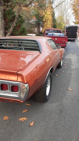

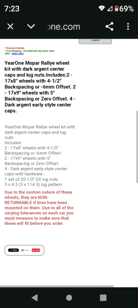

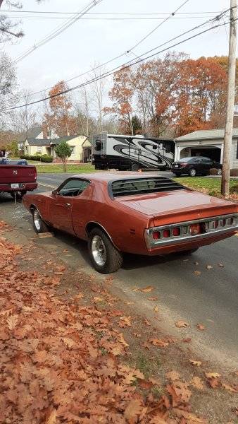

Any body running this wheel combo on a 71-72 Plymouth body ? If so what tire size are you running ?

a 10" wide section width-front tire at like 25-26"s on a 8" wide wheel
with a 4-1/2" backspacing
& a 11"- maybe 12" (?) wide section width-rear tire like 27-28" on a 9" wide wheel
with a 5" backspacing
