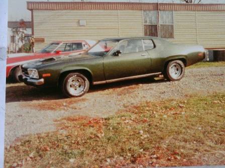

when I had my '73 back in the mid '80s, I ran 15x10s with G50s on it.No idea what the back space was.

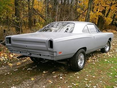

I have 15x8s on my '69 with 3.5 bs.
