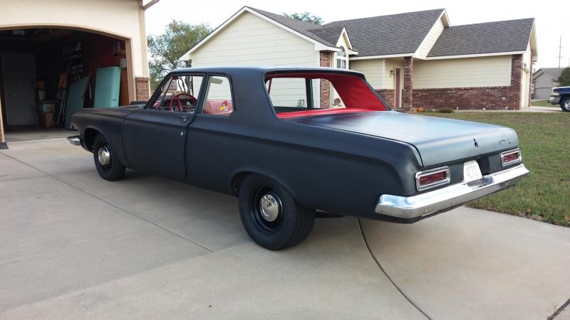

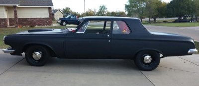

I bought the 63 series 15x8 and epoxied a smaller 9" dog dish inside a 10" cap.1028141002a.jpg1028141019-1.jpg
