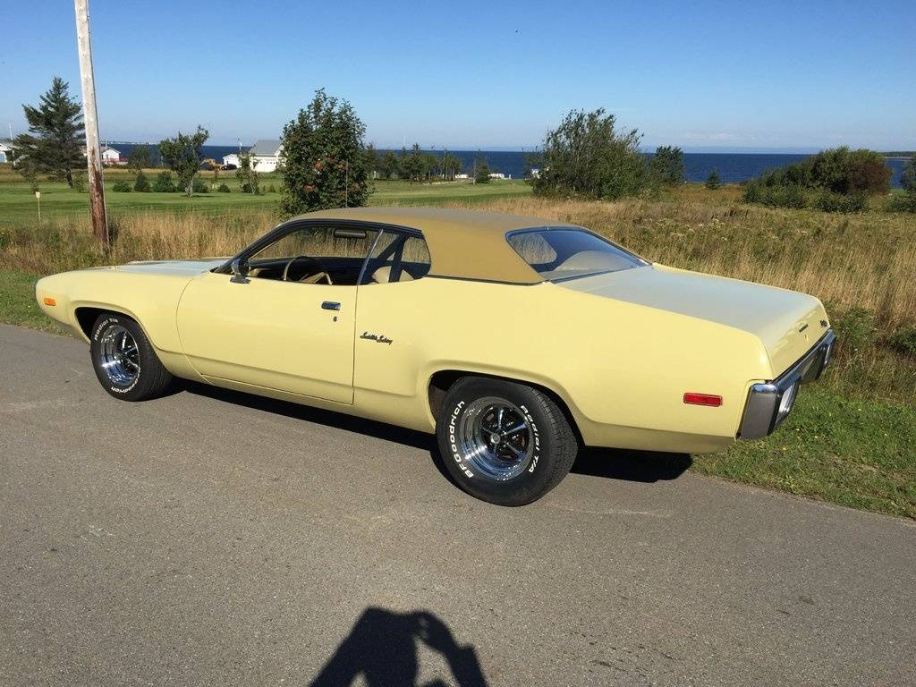

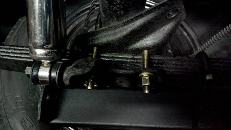

My rear suspension is all stock. Here you will see 26-12,5-15 MT Sportsman pro tires. That is maximum size for my 72 RR.

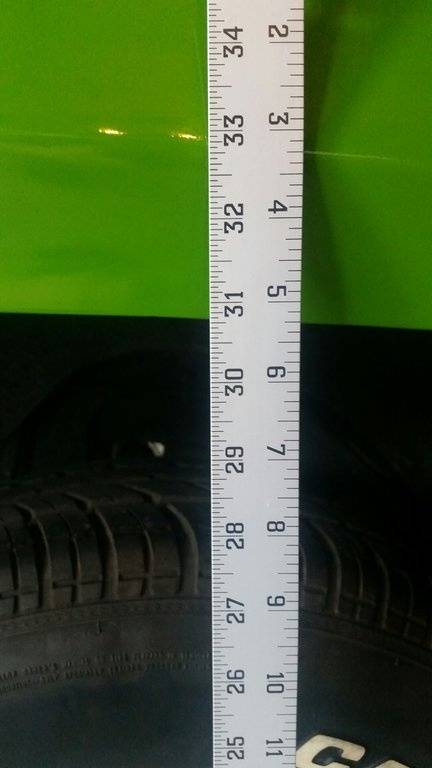

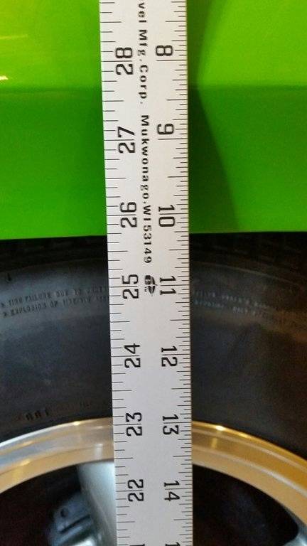

Thank you for all your replies. I guess a true answer would have to take into account the wheel size/tire and the actual raised level of the car after the new spring install. Just got my springs this week from General Spring. +2.5 inch. Looking to install shortly. Still wondering what the height will be from the ground to the wheel well after the new springs. Here is a few pics of where it sits right now. 25.75 from ground to wheel well. With tired springs. Sits a little too low for me. That is with a 225/70 R 15 tire. 27.36 tire diameter. 9.00 width.
Will be looking for a way bigger wheel/tire after the lift. My guess is with this current wheel /tire, that height after spring install will be 29.00. Any other educated guess's out there?

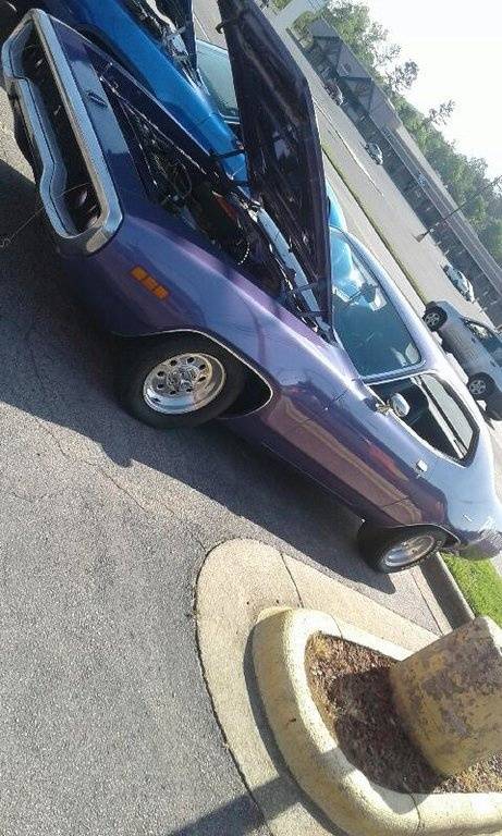

P 295 50 15 on the rear of my 71 with no modifications...stock springs and regular old gas shocks.
15 x 10 welds with 5.5 rear spacing.

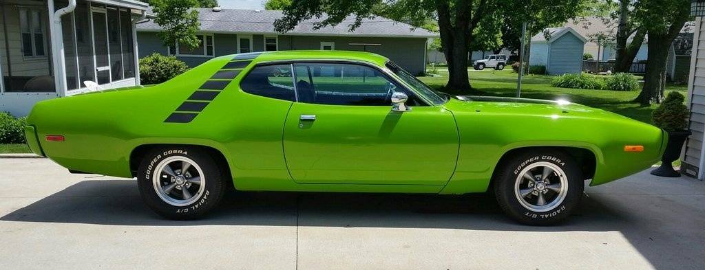

See what I mean?
You can get a LOT of tire in those generous wells.

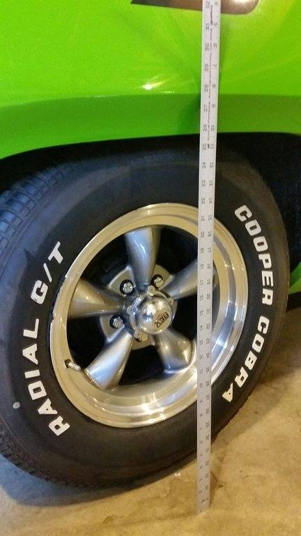

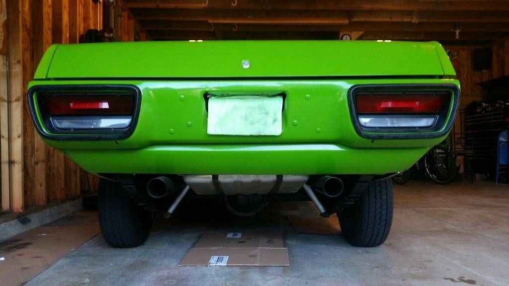

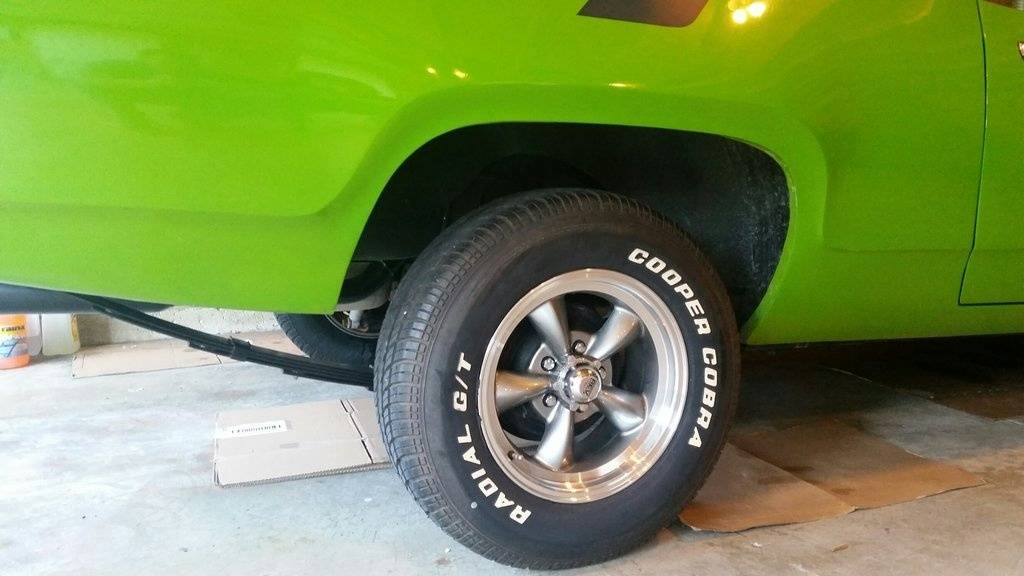

Finally got the new springs installed and oh boy is it jacked up. Passenger side wheel well height went from 24.75 to 30.90 inches. ( Driver side sits about .75 lower- about 30 inches). Way higher than I thought it would end up. No I need to find a new wheel and tire to fill this big opening. Don't even want to drive it with these skimpy 225/70/15's. Replaced the springs , shackles and all bushings. painted them up black before install and they look good. Also have new KYB shocks. From the center of the rear drums to the lip, I've got close to 17 inches, with the above tire size. Lots of room to go. Will be starting ANOTHER wheel/tire thread shortly. Thanks for all the past replies.
It's definitely up there but the small wheels really make it look even crazier. And the angle on that rear end pic is from the from the ground looking up, so it's kind of exaggerated. If I had a bigger tire in there right now-maybe a 30' diameter, it wouldn't look so bad. My original post was asking people on the forum for a measurement of their cars ground to wheel well height but only 1 reply actually gave me a measurement. And I'm about 3' inches higher than what was given -28'. No Air shocks. All spring. And they may settle up to 1 inch when all is said and done.

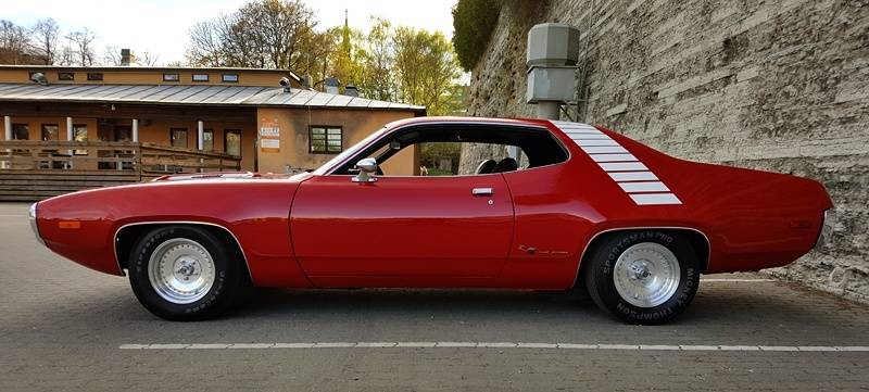

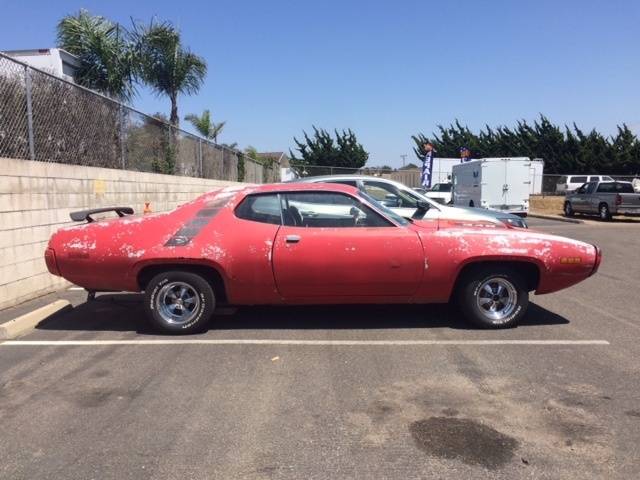

Here's mine. Sitting on 14's (245-60-14) Rear is at 26" to the bottom of that rusty fender lip.
Pretty sure it's going to have to go up in the rear to clear the 295-50-15's i have for it.
