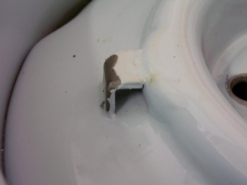

the mid '60's pick-up 15" wheels won't work with disc brakes. i've got a set of the wheels and know they won't clear the calipers unless you use some spacers. here is a pic of what i did to put early small hubcaps on later wheels.
Did you mean the larger hub caps on the later rims?

Thats a great idea for putting those caps on, how many of those tabs do you need to weld on and at what location? what size are those tabs? ?x? thanks John

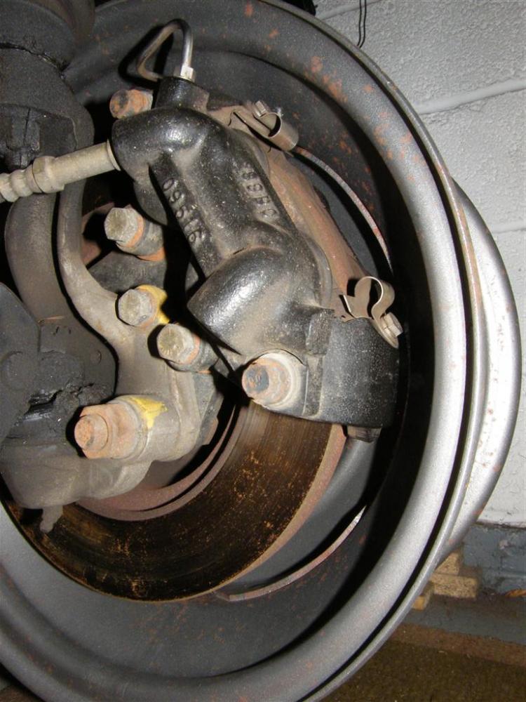

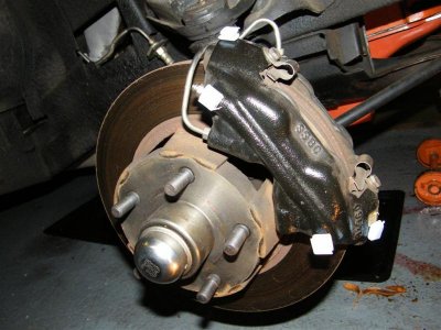

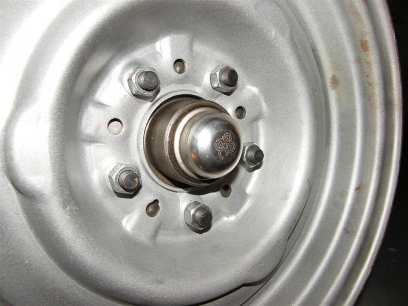

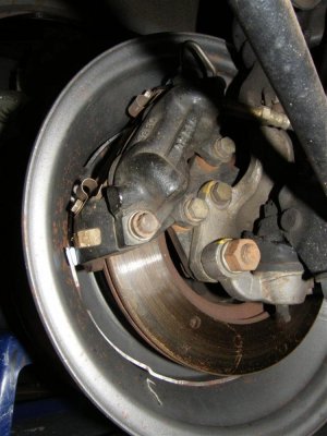

Just a bit of an update on the disc-brake will-it-or-wont-it-fit conundrum :D
Well I arranged to have one of the 15x5.5 wheels delivered so we fit could trial fit it over our SSBC caliper & disc. After a bit of a nervy minute or two, thinking it wasnt seated very well, we nipped up the wheel nuts and found that it was seated ok on the hub. The centre hole is a bit larger than the SSBC hub, which isnt ideal, but the tapered/chamfered nuts located the wheel sufficiently on the studs for that not too much of a concern.
To be sure it wasnt touching the caliper we put a few blobs of blu-tack on the extremities of the caliper and refitted the wheel. After removing the wheel again there was no evidence of the blu-tack being disturbed by the wheel so we were happy that it wasnt touching. We reckon there's at least 1/4" clearance all round.
Prior to trying the wheel on, I asked around a couple of people I thought might have already tried these wheels with disc brakes an one friend overe here said he had no problem fitting them on his 65 Belvedere that had Challenger front discs, and Mr Mosher himself :notworthy: said they have fitted a 15x4.4 wheel to SSBC brakes but have had to take the grinder to the caliper to give enough clearance. he thought the 5.5 would be ok hough. And he was right :icon_thumleft:
So, lewtot184, thanks for the warning; I'm glad we tried before buying the wheels, but thankfully there does seem to be some disc brakes that these early steels fit :icon_wink:
Pics below...
