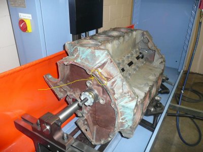

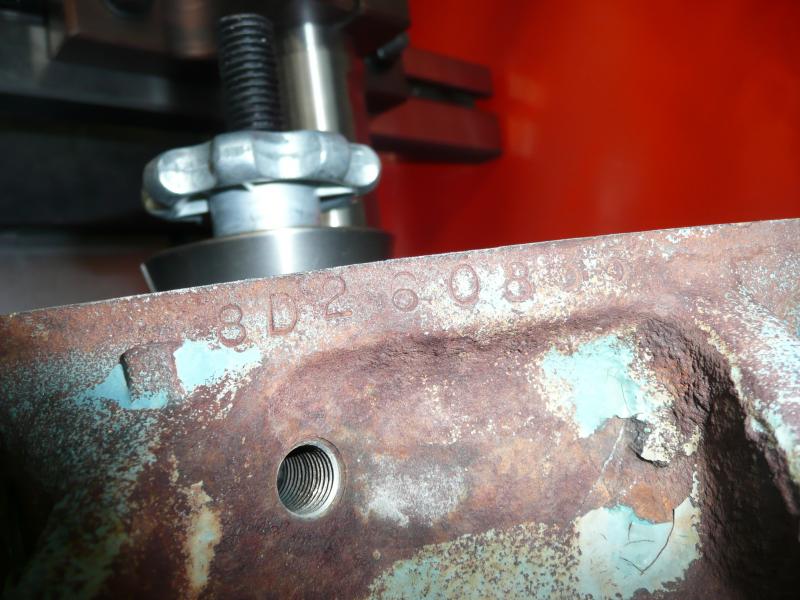

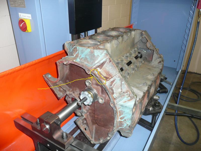

Here are two pics of a 1968 440. The vin stamping isn't always on the right (pass) side. This one is on the left (driver) side of the block.
Never seen a 68 one. thanks.
Almost looks hand stamped.
Could that be Belvidere plant only, I have a Lynch Road 383 stamped to the right side. Most I have seen are to the right. (Lynch Road and St Louis)
