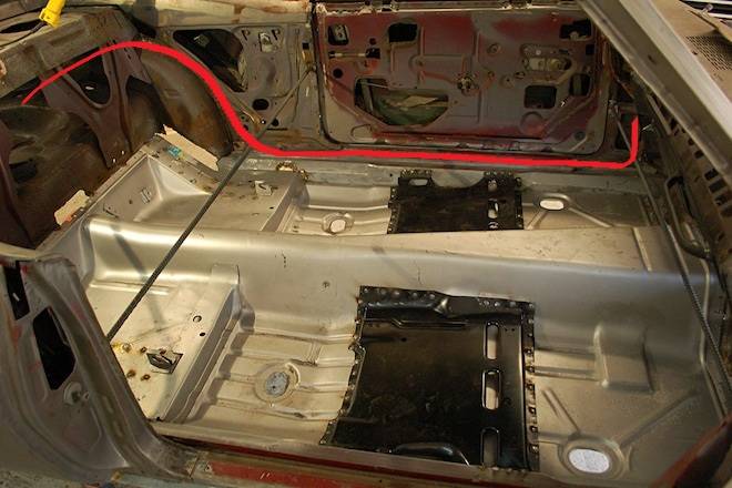

Where do the wires route from the backup light to the inside of the trunk 1969 Dodge Charger?
Almost all wiring for B bodies run down the driver side under the wire protectors From drivers kick panel to trunk.

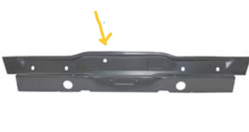

Sorry my bad, I’m looking for where they go out of the trunk to the backup lights.
I see the hole for the wire to go out to the tag light from the trunk but not the reverse.
The one car I saw locally drilled a hole behind the bumper and down to each light. I’d rather not do that.

I had the same question about the reverse lights and license plate light wire routing for my '70 Charger. It's difficult to see how they route with the bumper installed. At least with the Charger, once you remove the bumper, it's obvious to see the routing holes in the taillight panel and where a grommet goes to those holes, through which the wires are routed. It's difficult if not impossible to get at that area with the bumper in place.
I went out to my 69, but as stated previously, it's literally impossible to view it with the bumper on.
Please correct me if I'm wrong, but I believe a single grommet passes through the lower rear valance panel to the left of center. See stock picture...
That's pretty close to how it looks like on a '70 Charger too. My existing clump of wires in the trunk have a bunch that route through a round grommet, which goes in that hole on the left of center.
I’ve got that one.
I looked on Auto Metal Direct site after you posted that and mine is missing the other 2 holes that go to the backup lights.
Thanks for the help. I thought I was missing something.
