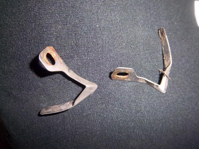

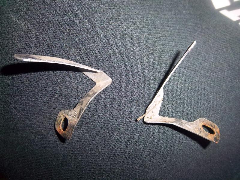

starting to put all of the parts back on my 70 belvedere. the parts have been off for over ten years and Im having trouble identifying some of them. these 2 clips i think are for the interior but dont know where they go can anyone help me. belverdere 001.jpgbelverdere 002.jpg
i think its clips for front windsheild molding, goes on the bottom corners
I would agree with tracy. They have a close resemblance to what is on my `66 as well.
Yep, they secure the bottoms of the front screen trim - on either side. Should be a screw hole on the pillar and they will line up. The thin tongue slides into the trim.
thanks!! you guys are a big help.all of the trim was off the car when I got it and none of it was marked. so i am sure i will have more questions about where pices go and how they are attached. thanks again for the help.
