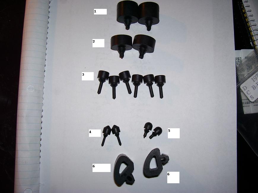

Hey folks, can someone help me out on where these rubber bumpers go? 73 Satellite
I know numbers 1 and 2 are for flip down license plate and for the hood.
Which one goes where? Smaller for license plate I am guessing. The ones for the hood, do they go in the holes in the hood in the far back corners?
3? 6 of these and I have no idea
4? Glovebox maybe or ash tray?
5? Glovebox or ash tray?
6? These I am sure are for the side of the hood and plug into the fenders. One of the only rubber pieces I had still on the car before tearing it down. I put the ones I had back in, but they aren’t hollow in the middle like this and are more of a solid “L”. Should I leave the others or put these on?

I check my 74 Charger Rallye with bulge hood and here is what mine has:
1) no idea(might be for a stock flat hood)
2) attached to hood, in hole closest to windshield(mine has 2 holes each side)
3) rear license plate bumpers
4) no idea(possibly front license plate)
5) ash reciever and glove box are the same on mine
6) I'm sure for hood to fender, but mine are L shaped like yours
