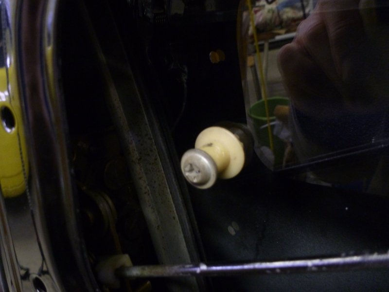

Isn't that the one that pushes through the door glass? Bottom corner kinda,?
Doesnt that extra hole in the glass give you a clue?

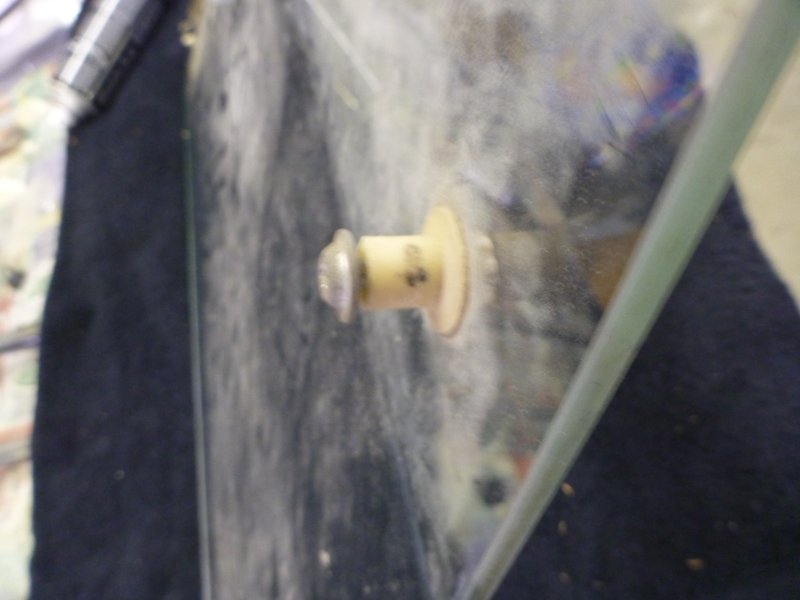

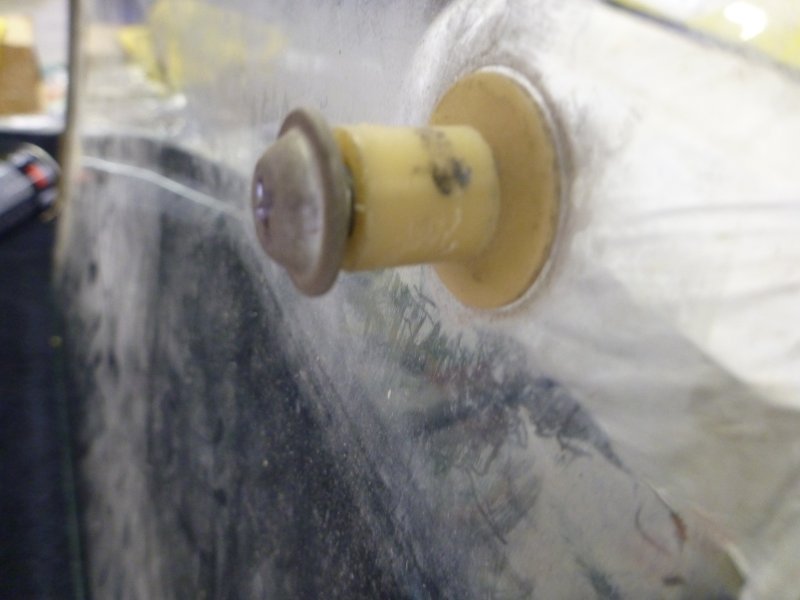

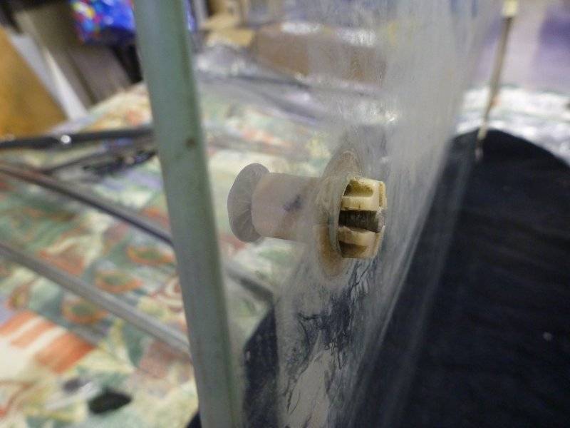

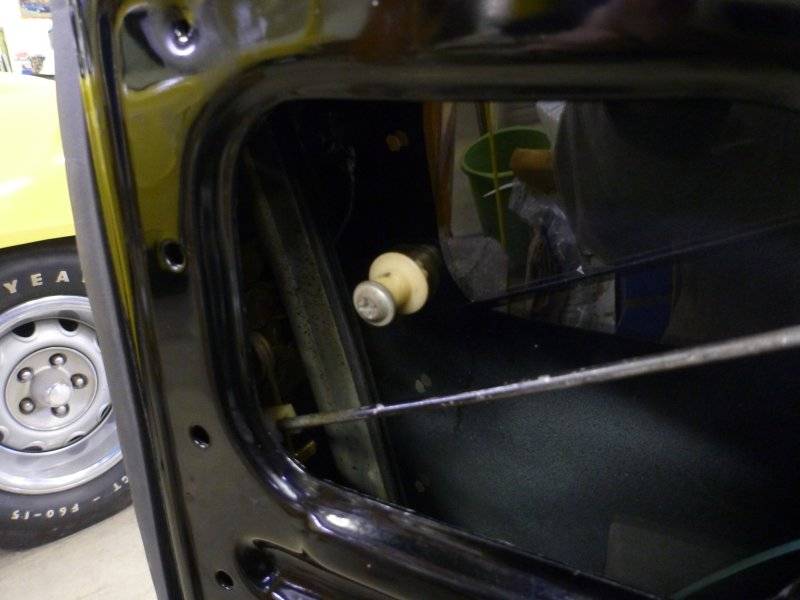

Installed after your vent frame and glass is in place... on a 69 and 70 at least. Maybe '68 just uses that bracket in your hand..IDK.
I did not see it shown in the 69 manual neither.
From what I see 68 has many differences than 69. Possibly an original 68 door glass does not have a hole for the stop. I assumed 68-70 was interchangeable. 69-70 oem May fit 68 but 68 oem may not fit 69-70. Here are some pics showing the differences. 68 on the left. Also 69-70 does not use the bracket he shows. Looks like the size puts them on top of each other. 68 top 69 bottom.

68 doesn't use it... Instead it uses the up stop bracket pictured in the four picture of post #1... That bracket contacts a tab on the regulator... The tab was eliminated on later regulators...
