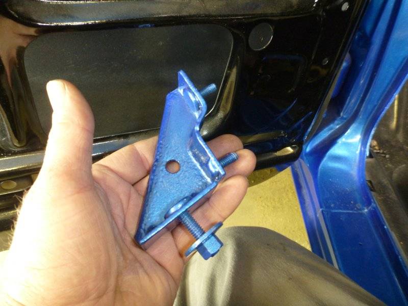

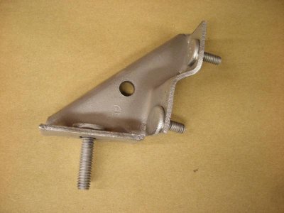

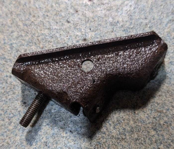

Anyone know if these are still being reproduced? I broke 2 studs off. I may try pressing them out and replacing as I searched and came up empty.

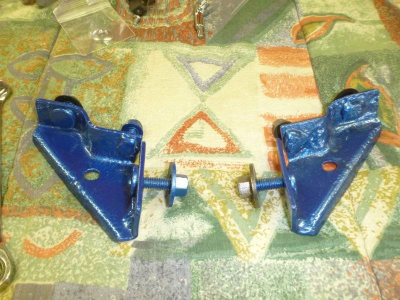

Just grind off the heads and drive the studs out. Weld the new ones in. Take it to a welding shop or a friend with the tools if you can't do it yourself. You could use a hex head bolt, a carriage bolt, a stud, or Ready Rod as long as it's welded on to secure it. You can grind down the head and weld if needed.
Drilled the threaded portion out on mine, tapped the remaining head, installed new stud and then welded head side. Worked just fine.

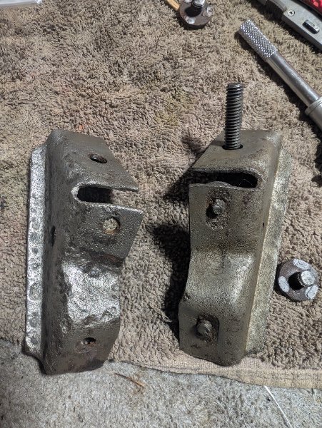

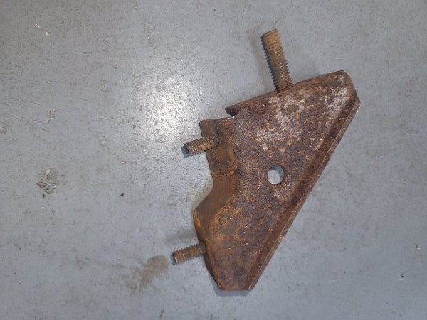

Bringing this back. Can anyone confirm the thread size and length. All 4 of the "smaller" ones broke off when I removed them over a year ago I'm getting ready to weld in some new studs
