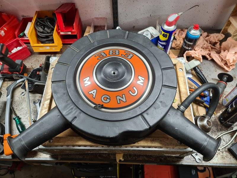

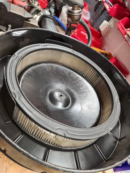

The filter i have now is 12.80"x 2-3/4" but it isnt tall enough, it needs to be like 3-11/32 to 3-1/2
Does anybody know?
If that's the same as mine, I believe it's a SA127. Autozone gives the height, but sadly not the dimensions
Not to throw a wrench into plans, but weren’t there different height air cleaner for 67s, or even other years?
My dads 67 is a little taller than mine, so his air cleaner doesn’t fit in mine. Now I’m trying to figure out where to get the one for mine.
Indeed there was, mine is the tall one and i went with a WIX 42043 and it fit's perfect
Thanks guys for your help! i went with a WIX 42043 and it fit's perfect
