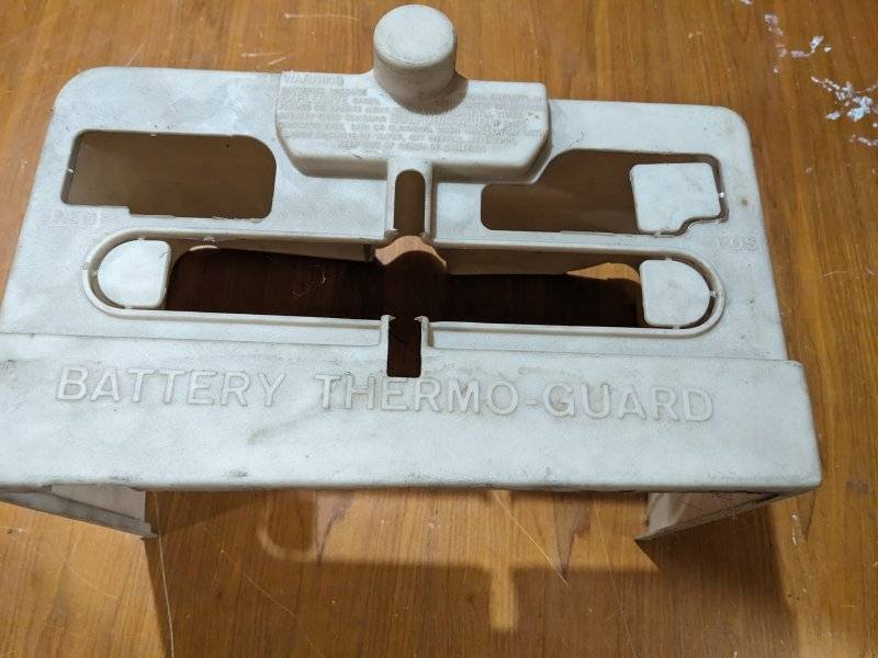

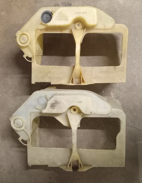

the top one with the black cap plug has been trimmed to fit a different style battery.
The lower one has been trimmed at the top right corner to clear the battery terminal. Aside from being trimmed, which one is correct for a 78 dodge magnum? Thanks in advance, Tony

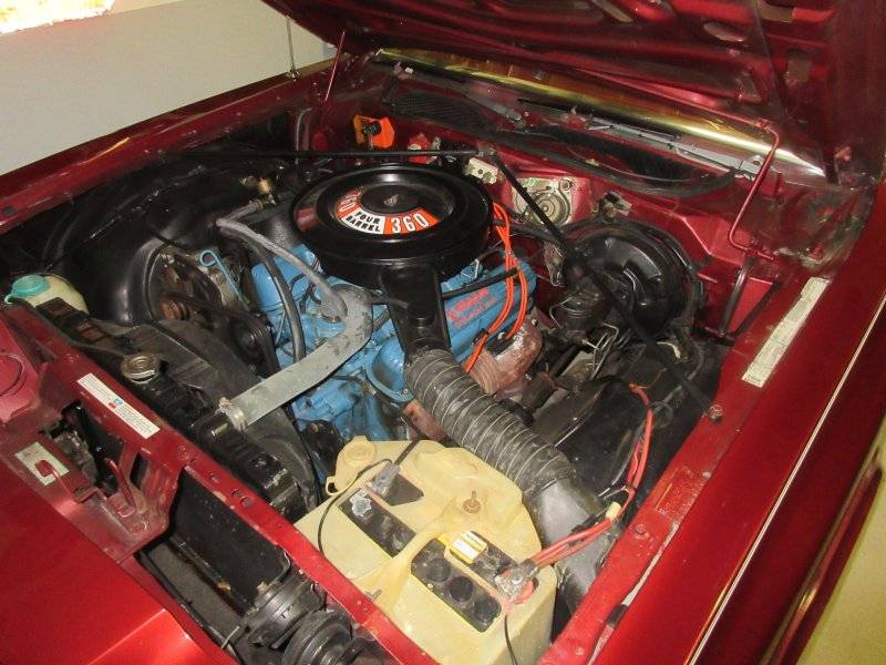

I can't guarantee my '78's thermoguard was the one it was born with, as I've only owned the car 3 years. But it probably is. It appears to be the lower one in your pictures.
Thanks for the pic. I wonder what happens when the pump dies? Drill a hole to access the nut and afterwards find a cap to re-seal it? Or back In the day, replace the whole thermguard with a new one. ? Just wondering.........Nice engine compartment!
The pump has a seal. I recently replaced the thermoguard in my Cordoba, along with a new pump. It's a simple task. Mine is like the one in the red engine compartment.

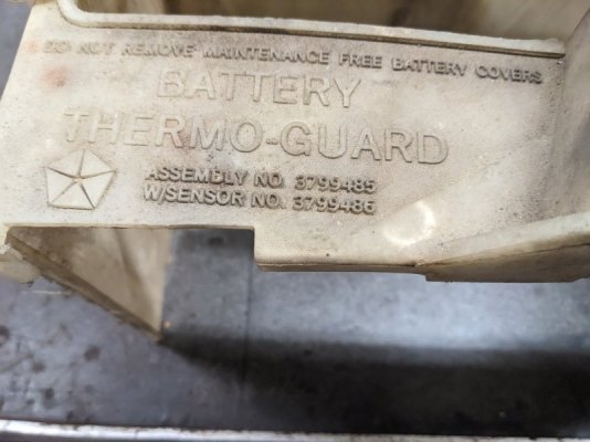

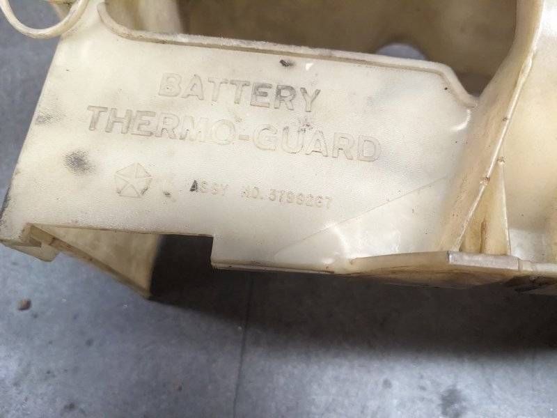

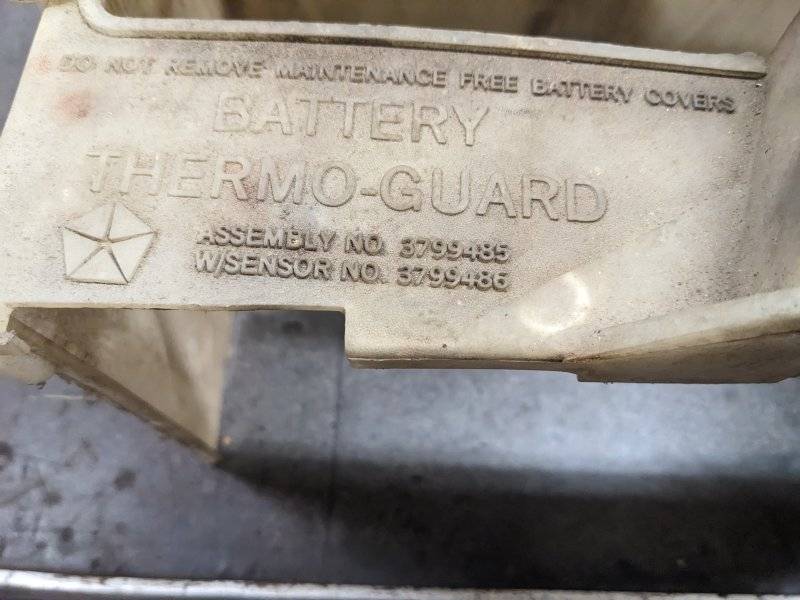

The battery heat shield, Thermo-Guard, was combined with the windshield washer reservoir for B-bodies for 1978. Part number 3799269, marked "ASSY NO. 3799267", was used up to 4-10-1978. Part number 3799494, marked "ASSY NO. 3799485 W/SENSOR NO. 3799486" was used after 4-10-1978 and continued through 1981 on the R-bodies.

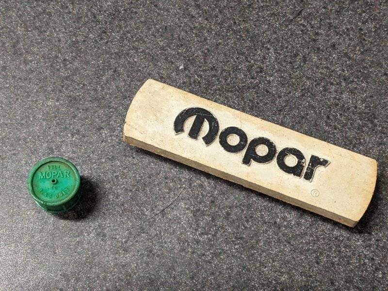

When assembled, the pump was installed first, and the upper part of the Thermo-Guard was glued to the bottom part. To replace the pump, if the reservoir had a sensor, the sensor is removed and the pump removed through the hole. If no sensor is installed the cut-out where it would be mounted is removed, and the pump removed through the hole. A black Caplug is installed in the cut out hole after the new pump is installed.

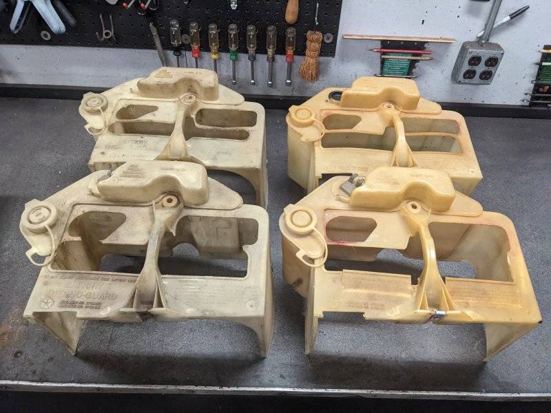

The following image is from the 1978 Service Highlights:
In the following image, the four Thermo-Guards include:
- upper left: 3799269
- upper right: 3799494 that has had the pump replaced
- lower left and right: 3799494 with fluid level sensor

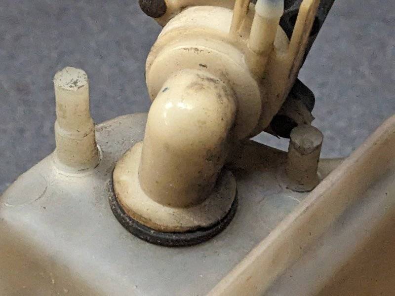

One difference between 3799269 and 3799494, in addition to the different markings, is the addition of two plastic posts, as a pump installation aid, which prevents the pump from turning as the "nut"/screen is tightened in the reservoir.
Another difference between 3799269 and 3799494 is the cutout for the battery vent caps was opened with the switch from individual battery cell caps to the multi-cell snap-in caps.

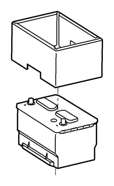

The prior B-body Thermo-Guard was part number 4005059 which was just the battery heat shield only without the combined washer reservoir:
The prior B-body Thermo-Guard was part number 4005059 with was just the battery heat shield only without the combined washer reservoir:

View attachment 1768660the top one with the black cap plug has been trimmed to fit a different style battery.
The one on the bottom. I've never seen one on a Magnum w/the rubber plug. If memory serves, that's for the fluid lever warning sensor
